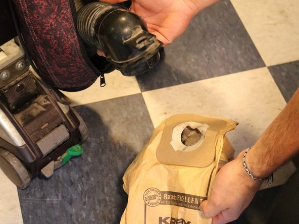

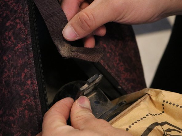

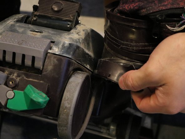

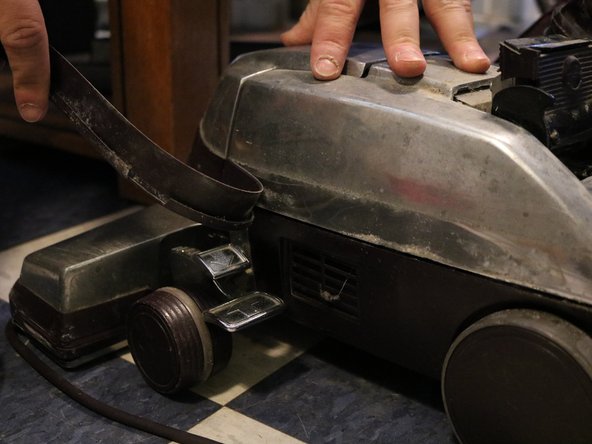

Pull rubber tab attached to recyclable bag off of adjoining plastic tab.
Remove recyclable bag completely by pulling the hose out of the back.

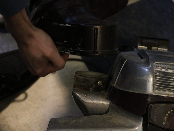

Unclip the top of the dust bag by holding in the clip and pulling down on the bag.
Twist the bottom of the bag counterclockwise and pull to fully remove from the vacuum.

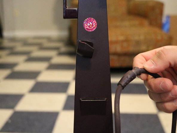

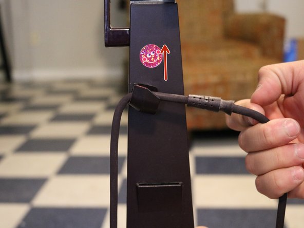

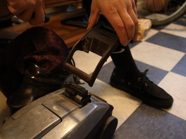

Remove cord from stem by pulling laterally then up.

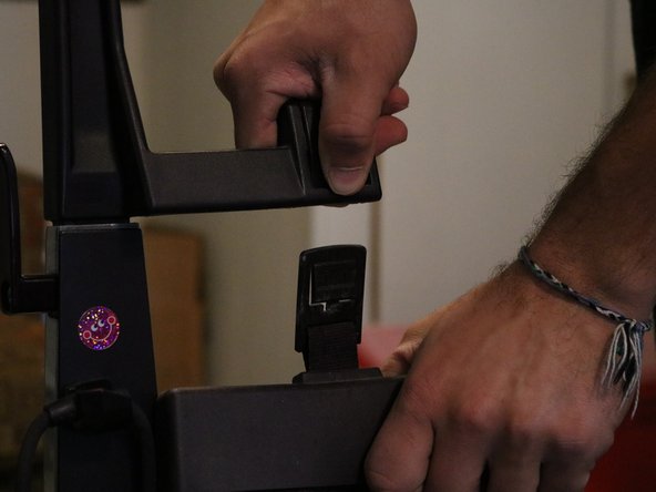

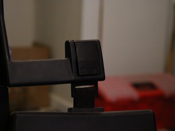

Remove the handle stem by pressing the button located at the bottom and pulling up on the stem.

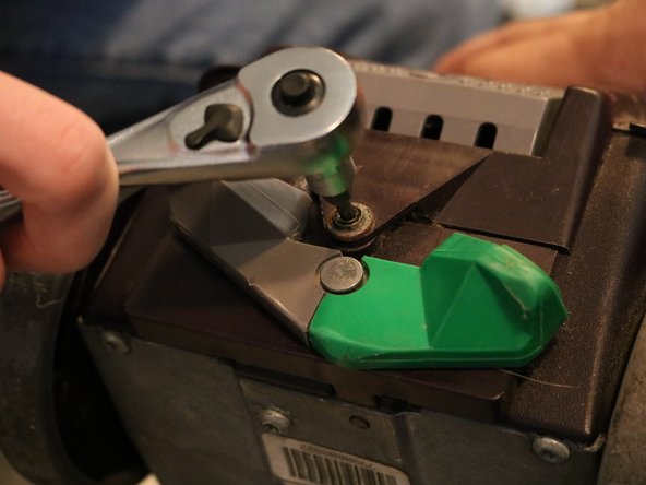

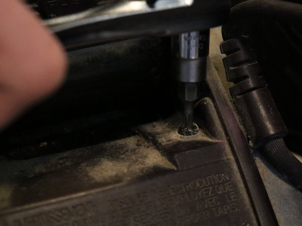

Unscrew the screw at the base of the vacuum using a T-15 socket.
Unscrew the screw at the back of the base of the vacuum.

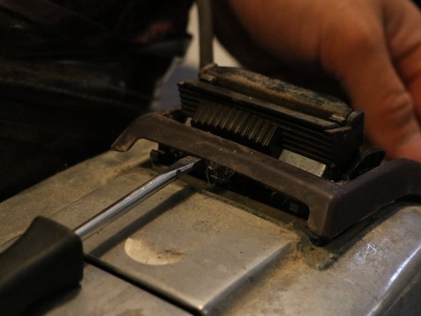

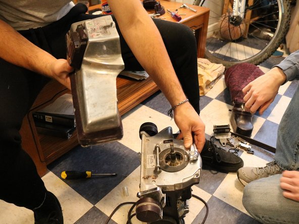

Remove the plastic covering on the back by using a flat head screw driver to carefully pry up the edges.

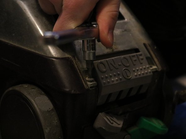

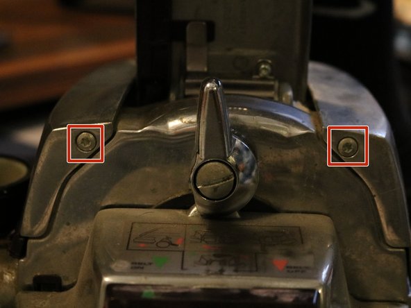

Unscrew both screws located next to the on/off switch using a T-15 socket.
Pull the plastic lining around the bottom of the vacuum off.

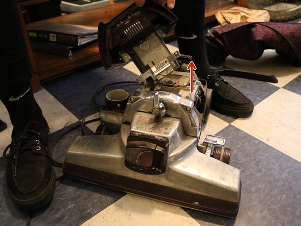

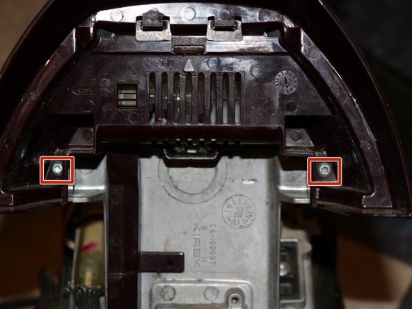

Open the front cover of the vacuum by pulling up from the bottom.
Unscrew both screws located inside at the top of the metal plate.
Remove the metal cover by pulling up, then out.
Undo the screw on the bottom side of the front cover

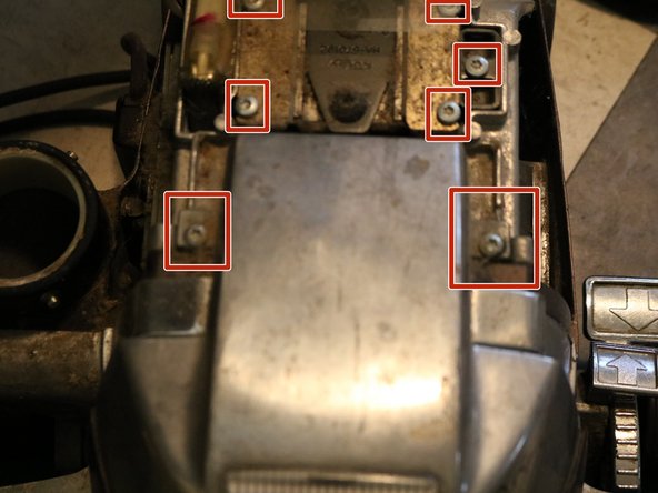

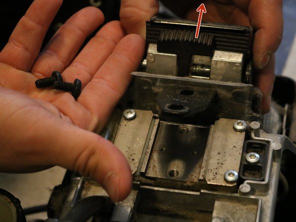

Undo all the screws revealed on top when the metal plate has been removed
Pull up on the piece to remove

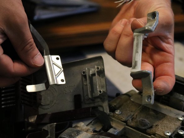

Unscrew the two screws located at the end of the piece removed in the previous step.

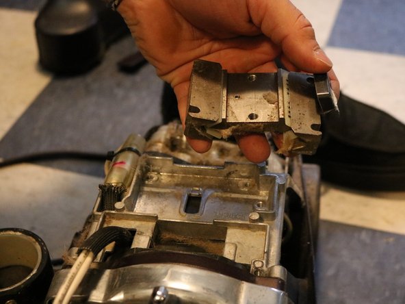

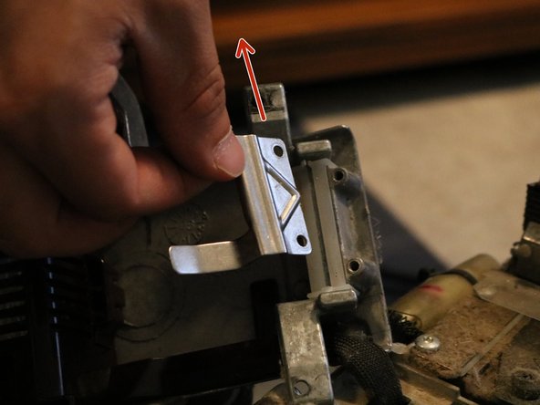

Pull up on the small metal piece to remove.
Pull up on the large metal piece now freed to remove.

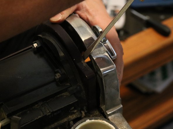

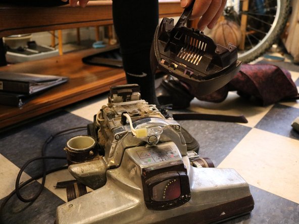

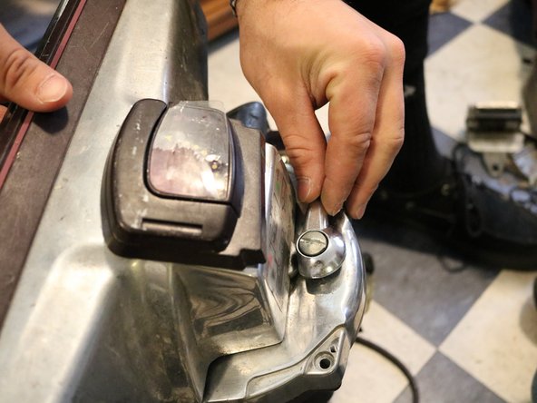

Push on the small plastic tab located at the top of the same part with a flat head
Pull lightly on the bulb cover to finish removing it

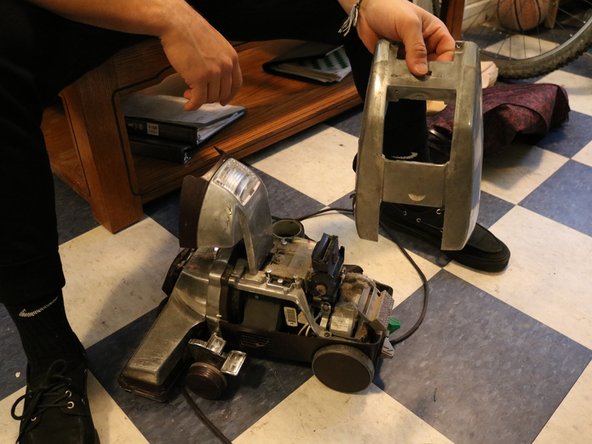

Unscrew the screws located inside the plastic holes.
Remove the metal cover by pulling up on it hard.

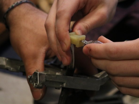

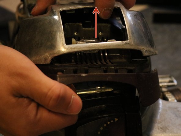

Remove the bulb from its clip by pulling up lightly
The plastic piece should now be free to remove from the vacuum.

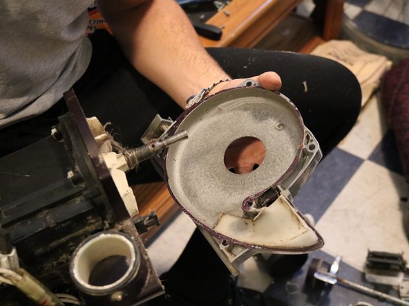

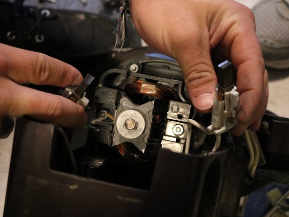

Undo the screws on the black plate located near the back of the vacuum using the T-20 bit.
Once the screws are removed, pull back on the plastic black tab and all attached parts will come off.
Using the T-20 bit, undo the smaller screws located in the same area.
Multiple pieces are now lose and should be removed from the holder.

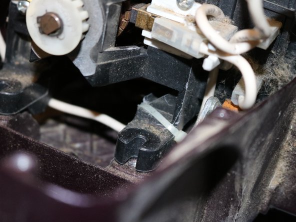

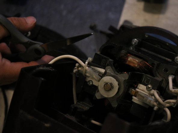

Cut zip ties that attach the wire to the plate.

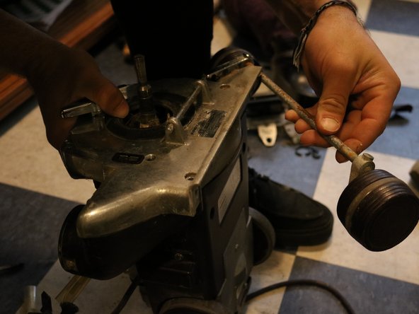

Undo screws on underside of the vacuum. These screws are the joint connection that are holding the wheels and axel to the vacuum.

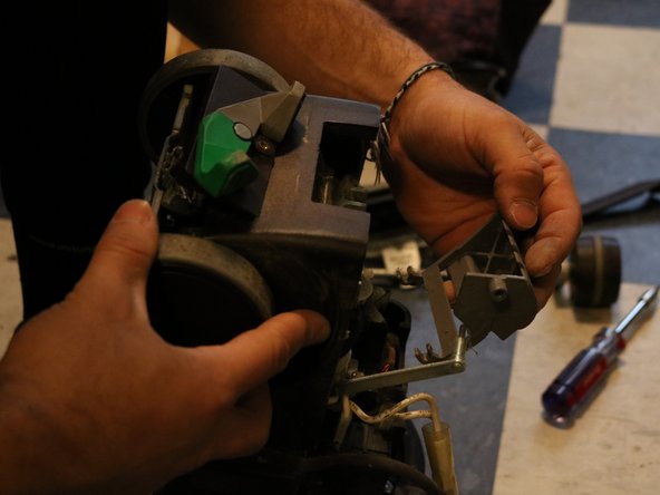

Pull down on the wheels to pull off.

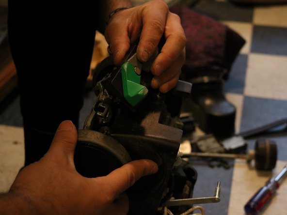

Pull off the on/off switch cover.
Pull down on the metal part on the back and the plastic switch should come out.
Finish pulling the metal part and attached axles out. If the axels are in need of cleaning, simply clean the existing axels with a wet clothe and put them back into the vacuum. If the axels are in need of replacement, use the new parts you have obtained and place them back in the same place as before and screw them back to the vacuum.

Cut the zip ties attaching all wires and detach the wires.

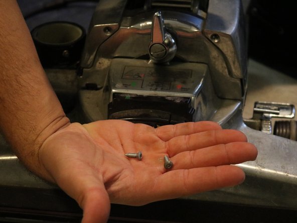

Using the Phillips screwdriver, undo the two screws shown on the front of the black plate and pull out the wires being held within it, carefully.

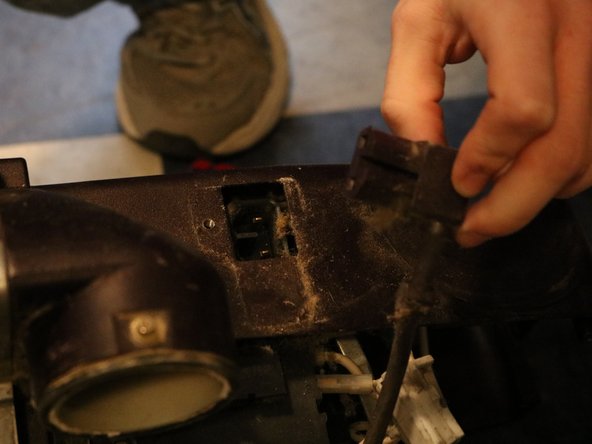

Next, undo the screw on the side of the vacuum shown. This will allow the plastic cover to detach from the system. Pull the plastic cover off.
This will allow you to unplug the electrical cord.

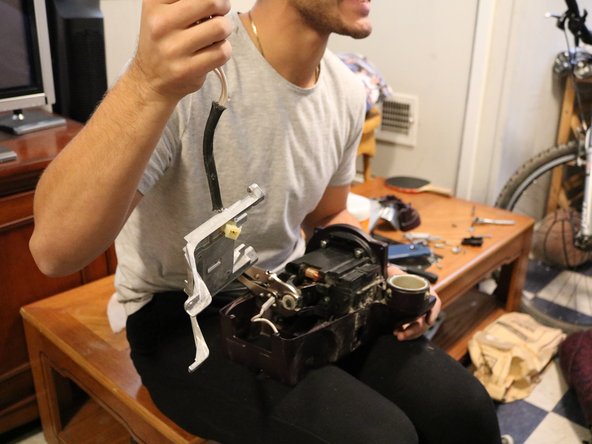

Disconnect all the wires to detach metal part.
Your Kirby G5 Micron Magic Vacuum is now disassembled.
