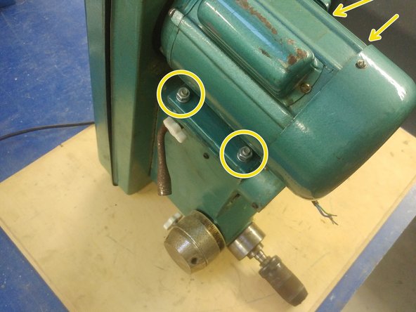

  3. Kinzo 8E116 Motor Bearing Replacement, disconnect motor from mount: crwdns2935265:03crwdnd2935265:01crwdnd2935265:03crwdne2935265:0 Kinzo 8E116 Motor Bearing Replacement, disconnect motor from mount: crwdns2935265:03crwdnd2935265:02crwdnd2935265:03crwdne2935265:0 Kinzo 8E116 Motor Bearing Replacement, disconnect motor from mount: crwdns2935265:03crwdnd2935265:03crwdnd2935265:03crwdne2935265:0

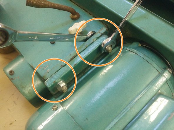

    • Using the 12 and 14 mm wrenches, loosen the mounting bolts.
    • Turn over the head and loosen the mounting bolts on that side as well.
    • Place the head with back facing up, remove the bolts and remove the motor from the mount.

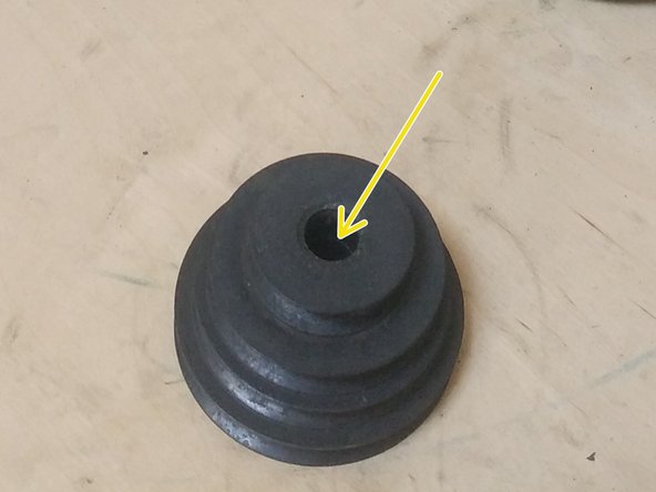

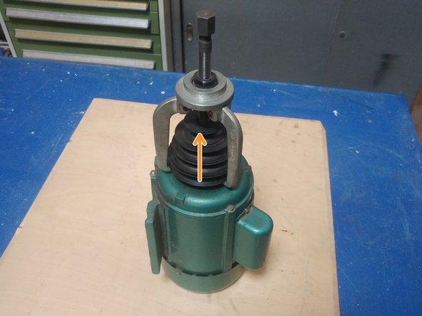

    • Remove the set screw from the pulley with the small flathead.
    • Remove the pulley from the shaft using a pulley removal tool.
    • The pulley has a diameter of 9 cm at its base.
    • Make sure the inside of the pulley is free of dirt or particles for easy reassembly.

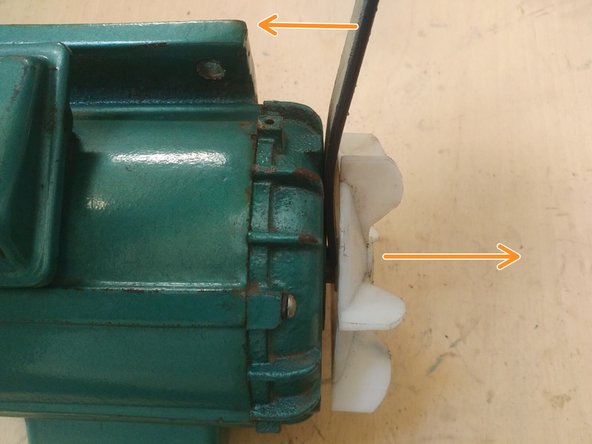

    • Remove the screws holding the fan cover and remove the cover. A few mallet taps might be needed to encourage the cover.
    • Use a small crowbar to leverage the fan from the shaft.

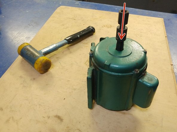

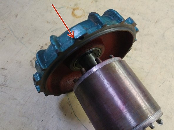

  6. Kinzo 8E116 Motor Bearing Replacement, remove rotor: crwdns2935265:06crwdnd2935265:01crwdnd2935265:03crwdne2935265:0 Kinzo 8E116 Motor Bearing Replacement, remove rotor: crwdns2935265:06crwdnd2935265:02crwdnd2935265:03crwdne2935265:0 Kinzo 8E116 Motor Bearing Replacement, remove rotor: crwdns2935265:06crwdnd2935265:03crwdnd2935265:03crwdne2935265:0

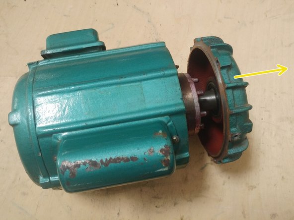

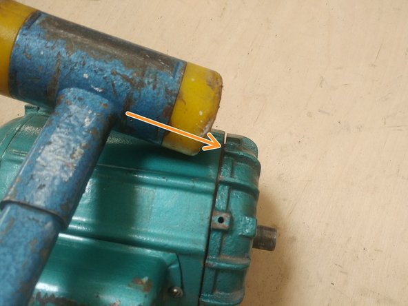

    • Unscrew the fan side motor housing bolts.
    • Use the mallet to tap around the cover edges and get it to loosen.
    • Once it is loose, the shaft, rotor and housing cover can be pulled from the motor housing.

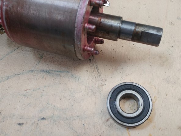

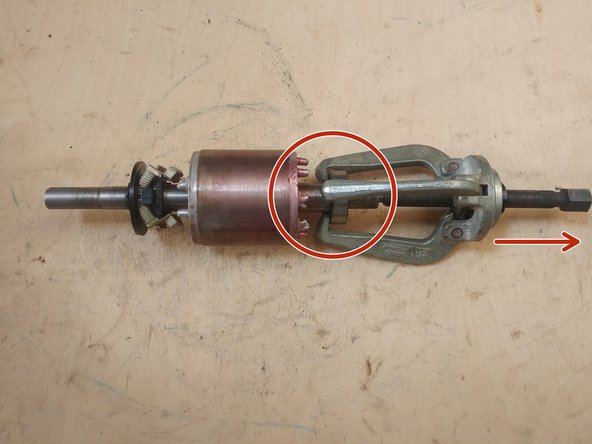

  7. Kinzo 8E116 Motor Bearing Replacement, remove fan sided bearing: crwdns2935265:07crwdnd2935265:01crwdnd2935265:03crwdne2935265:0 Kinzo 8E116 Motor Bearing Replacement, remove fan sided bearing: crwdns2935265:07crwdnd2935265:02crwdnd2935265:03crwdne2935265:0 Kinzo 8E116 Motor Bearing Replacement, remove fan sided bearing: crwdns2935265:07crwdnd2935265:03crwdnd2935265:03crwdne2935265:0
    • Carefully tap off the cover from the bearing with the mallet.
    • Pull the bearing from the shaft using the pulley removal tool.

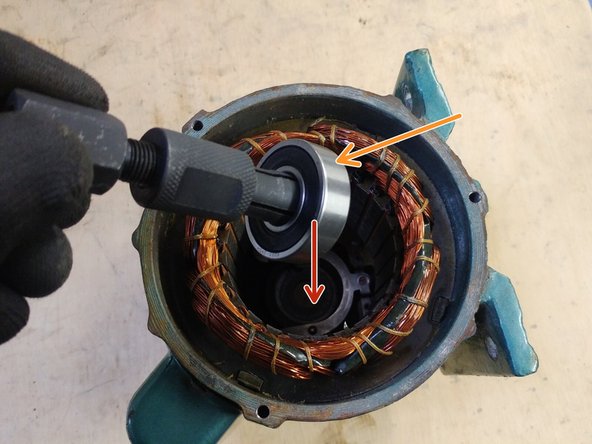

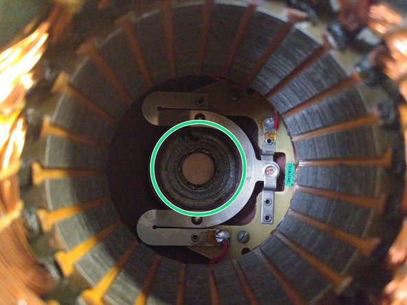

  8. Kinzo 8E116 Motor Bearing Replacement, remove pulley sided bearing: crwdns2935265:08crwdnd2935265:01crwdnd2935265:03crwdne2935265:0 Kinzo 8E116 Motor Bearing Replacement, remove pulley sided bearing: crwdns2935265:08crwdnd2935265:02crwdnd2935265:03crwdne2935265:0 Kinzo 8E116 Motor Bearing Replacement, remove pulley sided bearing: crwdns2935265:08crwdnd2935265:03crwdnd2935265:03crwdne2935265:0
    • The pulley sided bearing is located in the motor housing.
    • Clamp the bearing from the pulley side with the bearing removal tool, and use the mallet to hit it from its seat.
    • Clean the bearing seat.
  9. Kinzo 8E116 Motor Bearing Replacement, replace pulley sided bearing: crwdns2935265:09crwdnd2935265:01crwdnd2935265:03crwdne2935265:0 Kinzo 8E116 Motor Bearing Replacement, replace pulley sided bearing: crwdns2935265:09crwdnd2935265:02crwdnd2935265:03crwdne2935265:0 Kinzo 8E116 Motor Bearing Replacement, replace pulley sided bearing: crwdns2935265:09crwdnd2935265:03crwdnd2935265:03crwdne2935265:0
    • Before replacement, make sure the shafts, bearing seats, and bearings are clean and lubricated for easy reassembly.
    • Insert the new bearing into the empty seat in the motor housing.
    • Use the bearing removal tool to grip the inside.
    • While centering the bearing, tap the bearing around the outside to press it a little into the seat.
    • Remove the bearing removal tool, and keep tapping around the outside of the bearing until it is fully in.
