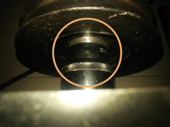

  2. Kinzo 8E116 Center Pulley Bearing Replacement, remove axle: crwdns2935265:02crwdnd2935265:01crwdnd2935265:03crwdne2935265:0 Kinzo 8E116 Center Pulley Bearing Replacement, remove axle: crwdns2935265:02crwdnd2935265:02crwdnd2935265:03crwdne2935265:0 Kinzo 8E116 Center Pulley Bearing Replacement, remove axle: crwdns2935265:02crwdnd2935265:03crwdnd2935265:03crwdne2935265:0
    • Remove the internal retaining ring with the snap ring pliers.
    • Remove the external retaining ring with the snap ring pliers.
    • Press out the axle with the pulley puller.

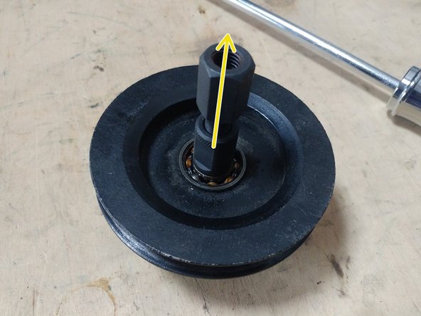

  3. Kinzo 8E116 Center Pulley Bearing Replacement, remove bearings: crwdns2935265:03crwdnd2935265:01crwdnd2935265:03crwdne2935265:0 Kinzo 8E116 Center Pulley Bearing Replacement, remove bearings: crwdns2935265:03crwdnd2935265:02crwdnd2935265:03crwdne2935265:0 Kinzo 8E116 Center Pulley Bearing Replacement, remove bearings: crwdns2935265:03crwdnd2935265:03crwdnd2935265:03crwdne2935265:0
    • The pulley contains 2 bearings separated with a spacing ring.
    • Using the bearing removal tool, pull out the first bearing.
    • Optionally, you can use a socket to tap out the second bearing. Make sure to use a socket that fits the outer ring of the bearing.
    • Pull out the second bearing with the bearing removal tool.

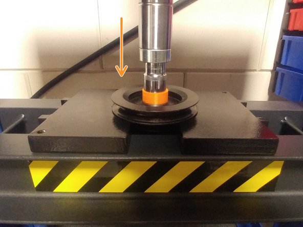

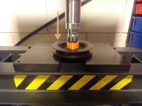

  4. Kinzo 8E116 Center Pulley Bearing Replacement, replace first bearing: crwdns2935265:04crwdnd2935265:01crwdnd2935265:02crwdne2935265:0 Kinzo 8E116 Center Pulley Bearing Replacement, replace first bearing: crwdns2935265:04crwdnd2935265:02crwdnd2935265:02crwdne2935265:0
    • When pressing in the bearing, make sure the pressure is spread on the inside and outside ring of the bearing.
    • Place the first bearing on the pulley.
    • Press in the bearing to the bottom of the pulley.

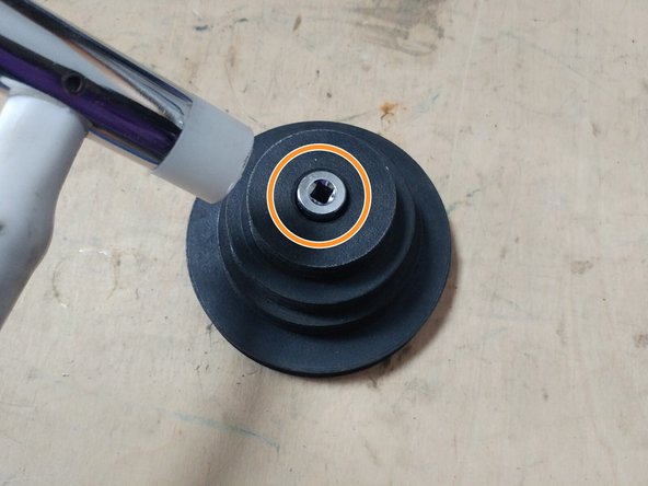

  5. Kinzo 8E116 Center Pulley Bearing Replacement, replace second bearing: crwdns2935265:05crwdnd2935265:01crwdnd2935265:02crwdne2935265:0 Kinzo 8E116 Center Pulley Bearing Replacement, replace second bearing: crwdns2935265:05crwdnd2935265:02crwdnd2935265:02crwdne2935265:0
    • Insert the spacer onto the first bearing.
    • Press in the second bearing until it touches the spacer.

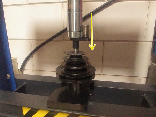

  6. Kinzo 8E116 Center Pulley Bearing Replacement, press the axle back in: crwdns2935265:06crwdnd2935265:01crwdnd2935265:03crwdne2935265:0 Kinzo 8E116 Center Pulley Bearing Replacement, press the axle back in: crwdns2935265:06crwdnd2935265:02crwdnd2935265:03crwdne2935265:0 Kinzo 8E116 Center Pulley Bearing Replacement, press the axle back in: crwdns2935265:06crwdnd2935265:03crwdnd2935265:03crwdne2935265:0
    • When pressing in the axle, ensure that the bearings are not pressed out again by supporting the bearings.
    • Use a spacer that can hold in the bearing, but allow the axle to be pressed through.
    • You can 3D print such a spacer, or use the outer ring of the replaced bearing (ground down to prevent press fit).
    • Place the spacer.
    • Let the spacer push on something, a large socket for instance, and center it on the press.
    • Press in the axle until the retaining ring groove is above the bearing (and the retaining ring can be put back).
