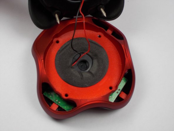

    • Separate the resonator portion from the base of device to reveal the middle separator of the enclosure. The enclosure will now be in two pieces.
    • Hold the resonator portion of the enclosure gently aside to make sure there is no tension on the black and red wires coming from the bottom portion of the device.
    • Excessive force may disconnect the black and red speaker wires from the circuitry in the bottom portion of the device.
  4. Kinivo ZX100 Mini Portable Speaker LED Indicator Replacement: crwdns2935265:04crwdnd2935265:01crwdnd2935265:01crwdne2935265:0
    • Separate the very bottom portion of the enclosure (marked in red) by pulling vertically on the red portion of the enclosure (marked in orange).
    • Gently set the very bottom portion and the resonator section aside once they have both been separated.

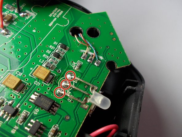

  5. Kinivo ZX100 Mini Portable Speaker LED Indicator Replacement, LED Indicator: crwdns2935265:05crwdnd2935265:01crwdnd2935265:01crwdne2935265:0
    • LED Locating
    • Locate the three, metal prongs found near the edge of the circuit board. They are found directly behind the LED light.
    • Soldering
    • If you are not familiar with the process of soldering, please refer to an online manual.
    • Heat the soldering iron to operating temperature.
    • Avoid touching the heated tip of the iron to ensure that you do not burn yourself.
  6. Kinivo ZX100 Mini Portable Speaker LED Indicator Replacement: crwdns2935265:07crwdnd2935265:01crwdnd2935265:02crwdne2935265:0 Kinivo ZX100 Mini Portable Speaker LED Indicator Replacement: crwdns2935265:07crwdnd2935265:02crwdnd2935265:02crwdne2935265:0
    • Prong Removal
    • The picture in this step calls for speaker wire, but it can also be applied for the removal of each prong.
    • Remove a single prong by pulling it directly up from the circuit board using tweezers.
    • Repeat the previous until all three prongs have been removed.
  7. Kinivo ZX100 Mini Portable Speaker LED Indicator Replacement: crwdns2935265:08crwdnd2935265:01crwdnd2935265:01crwdne2935265:0
    • Replacement
    • Obtain a new LED component from a manufacturer.
    • Perform the steps in reverse order to reconnect the new LED to the circuit board.
