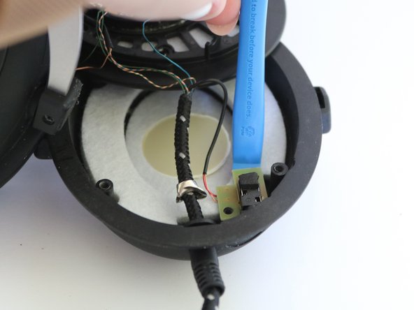

      • Remove the two 6.1 mm microphone jack input screws using a Phillips #0 screwdriver.
      • Gently place an iFixit opening tool under the microphone jack board, and remove the microphone jack insert.

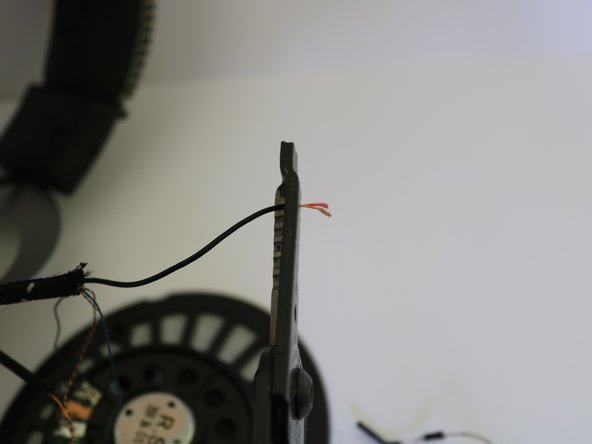

      • Carefully remove approximately half of the wire insulation from the exposed cable from Step 4 using a pair of wire strippers.
      • Ensure wires under the insulation are not damaged from this process.
      • Carefully separate the wires by color.

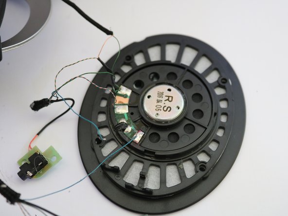

      • Use a soldering iron to solder the edges of your new cable wires.
      • Plug your new cable into a compatible device and check the wires are working by ensuring voltage using a multimeter.
      • Desolder the old wire from the speaker and solder the new wire to the speaker with the same color until the old cable connection wires are completely removed and the new cable connection wires are soldered to the speaker.

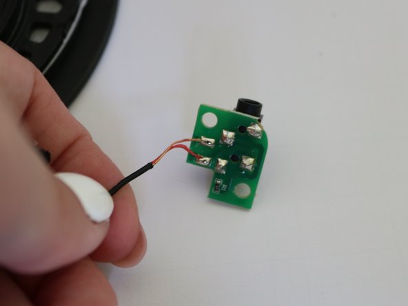

      • A black wire will be left; this is more insulation to protect two smaller wires that go to the microphone jack.
      • Using wire strippers and solder, remove the insulation and follow the same color match and solder process from Step 7.
