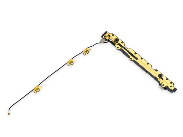

    • Seeing as the "Wi-Fi + Free 3G" Kindle Voyage—the one that lets you spend money on ebooks anywhere (for free!)—won't be available until next month, our model is Wi-Fi only.
    • This makes identifying this large antenna bar fairly straightforward.
    • Hello, Wi-Fi antenna.

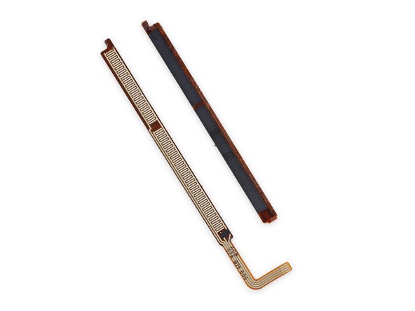

    • As we continue to explore the Voyage, we come across the PagePress sensors. The sensors are held to the display assembly with some mild adhesive for good contact.
    • What exactly is PagePress? Glad you asked.
    • "PagePress is a custom-designed force sensor made of carbon and silver, which reacts to a subtle increase of pressure, triggers a page-turn, and provides a haptic response only your thumb can perceive."
    • Sounds like some kind of strain gauge implementation to us. A strain gauge is a component that changes resistivity when deformed, making for an excellent buttonless button.
