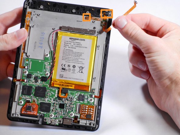

  7. Kindle Voyage Ambient Light Sensor Replacement, Ambient Light Sensor: crwdns2935265:07crwdnd2935265:01crwdnd2935265:02crwdne2935265:0 Kindle Voyage Ambient Light Sensor Replacement, Ambient Light Sensor: crwdns2935265:07crwdnd2935265:02crwdnd2935265:02crwdne2935265:0
    • Gently remove the connector to the motherboard using tweezers.
    • Continue to carefully pull the rest of the connector from the adhesive connecting it to the Voyage.
    • Detach sensor from the top using fingers
