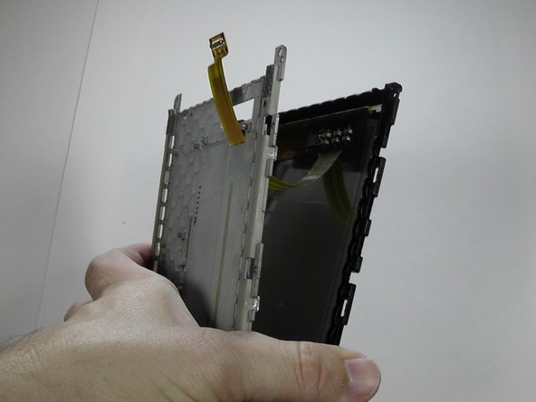

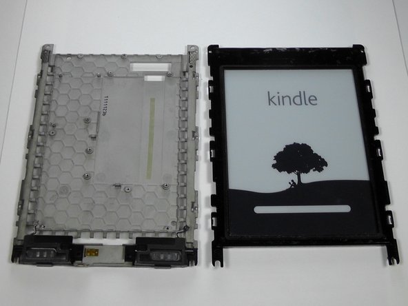

    1. Kindle Touch Screen Replacement, Screen: crwdns2935265:013crwdnd2935265:01crwdnd2935265:03crwdne2935265:0 Kindle Touch Screen Replacement, Screen: crwdns2935265:013crwdnd2935265:02crwdnd2935265:03crwdne2935265:0 Kindle Touch Screen Replacement, Screen: crwdns2935265:013crwdnd2935265:03crwdnd2935265:03crwdne2935265:0
      • Using your Metal Spudger, place the pointy end into the top of the clip.
      • Gently rotate the Spudger and lift the plastic unit to create a gap on the side.
    2. Kindle Touch Screen Replacement: crwdns2935265:014crwdnd2935265:01crwdnd2935265:02crwdne2935265:0 Kindle Touch Screen Replacement: crwdns2935265:014crwdnd2935265:02crwdnd2935265:02crwdne2935265:0
      • Use the Spudger in the gap to pry the clip open.
      • Repeat for the other clips.
    3. Kindle Touch Screen Replacement: crwdns2935265:015crwdnd2935265:01crwdnd2935265:03crwdne2935265:0 Kindle Touch Screen Replacement: crwdns2935265:015crwdnd2935265:02crwdnd2935265:03crwdne2935265:0 Kindle Touch Screen Replacement: crwdns2935265:015crwdnd2935265:03crwdnd2935265:03crwdne2935265:0
      • With the clips separated, gently guide the Screen's Motherboard Connector through the hole.
