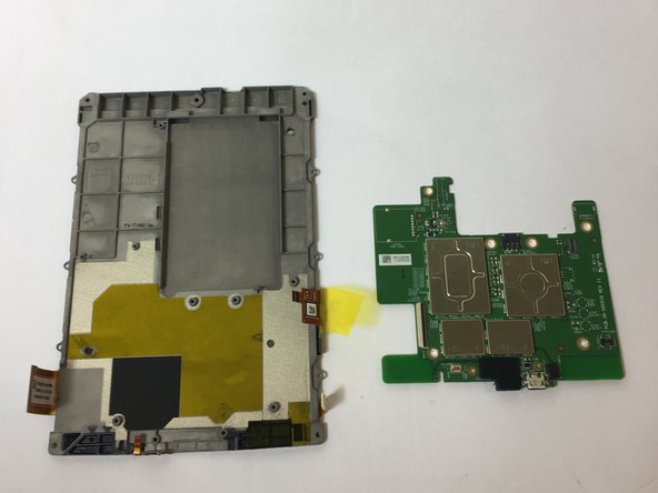

  7. Kindle Paperwhite 2nd Generation Charging Port Replacement: crwdns2935265:07crwdnd2935265:01crwdnd2935265:02crwdne2935265:0 Kindle Paperwhite 2nd Generation Charging Port Replacement: crwdns2935265:07crwdnd2935265:02crwdnd2935265:02crwdne2935265:0
    • Gently disconnect the zif connectors.
    • Some of these connectors are very thin and fragile, handle with care!
  8. Kindle Paperwhite 2nd Generation Charging Port Replacement: crwdns2935265:08crwdnd2935265:01crwdnd2935265:03crwdne2935265:0 Kindle Paperwhite 2nd Generation Charging Port Replacement: crwdns2935265:08crwdnd2935265:02crwdnd2935265:03crwdne2935265:0 Kindle Paperwhite 2nd Generation Charging Port Replacement: crwdns2935265:08crwdnd2935265:03crwdnd2935265:03crwdne2935265:0
    • Gently remove the motherboard.

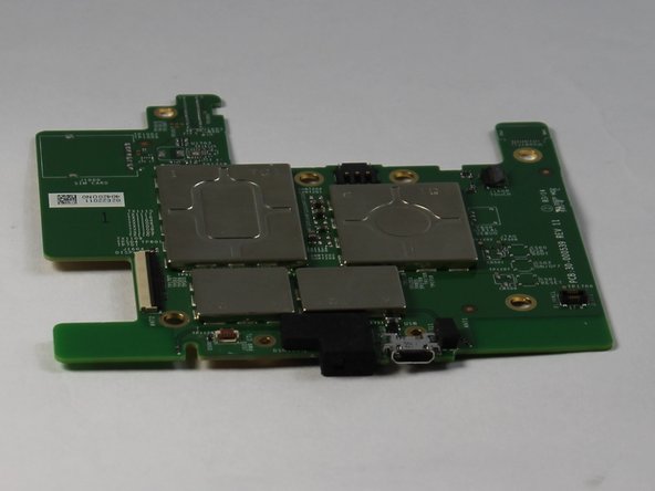

  9. Kindle Paperwhite 2nd Generation Charging Port Replacement, Charging Port: crwdns2935265:09crwdnd2935265:01crwdnd2935265:01crwdne2935265:0
    • The charging port is integrated in to the device motherboard.
    • From here, to fix a faulty port, either replace the entire motherboard, or carefully desolder the old port and solder a new one on in its place.
    • Check out the soldering guide for help.

How to replace the USB port; replace the motherboard. Kind of a lame fix if you ask me. Whatever happened to soldering a new port on?
Sam Hardeman - crwdns2934203:0crwdne2934203:0
I have not done the fix yet but plan to replace the USB which appears to be a USB - micro B USB 2.0 Receptacle Connector 5 Position Surface Mount available at DigiKey. Is there any reason not to attempt this? I have microscope and soldering station. If not, where do you get the motherboard and how much is it?

Démontage facile effectivement, mais les cinq microsoudures sur la carte mère sont impossibles à faire avec un simple fer à souder ! Il faut utiliser du matériel pour CMS (composant à montage en surface)…
Ceci dit mon problème vient effectivement de ces microsoudures. En appuyant simplement sur ces contacts mon Kindle s’est remis en marche ! Vive le travail mal fait à la construction…
telerando - crwdns2934203:0crwdne2934203:0
Getting the Kindle open and getting to the charging port was quite ‘easy’. In step 1 the top is stuck on with something like sticky back tape and the top can be gently pulled away from the tape.
Having got to the port I can not figure out how to replace it. This part does not seem to be easy, unless Step 9 is explained in much more detail. The contacts for the port seem to be incredibly small and I can’t figure out how they’re connected, or what part I need to order to replace the port.
