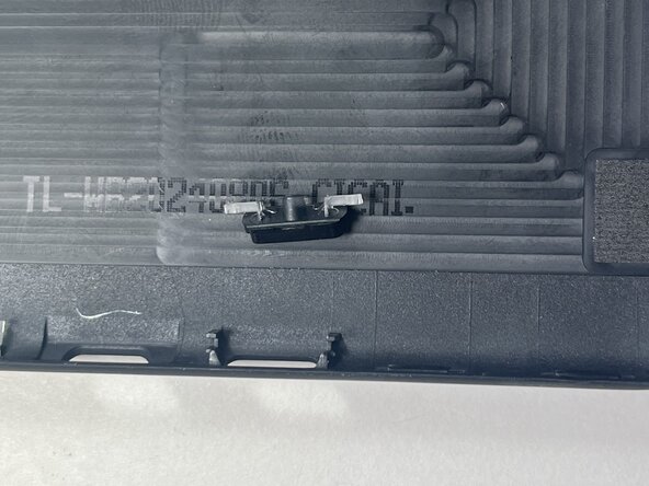

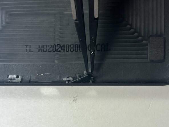

  3. Kindle Paperwhite 12th Gen Power Button Replacement, Power button: crwdns2935265:03crwdnd2935265:01crwdnd2935265:03crwdne2935265:0 Kindle Paperwhite 12th Gen Power Button Replacement, Power button: crwdns2935265:03crwdnd2935265:02crwdnd2935265:03crwdne2935265:0 Kindle Paperwhite 12th Gen Power Button Replacement, Power button: crwdns2935265:03crwdnd2935265:03crwdnd2935265:03crwdne2935265:0
    • Use tweezers or your fingers to release the clips on each side of the button, gently lifting one side at a time.
    • The button housing is located at the bottom left of the charging port.
