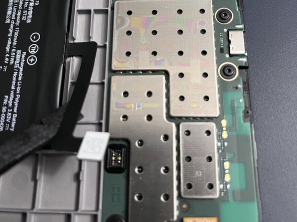

    8. Kindle Paperwhite 11th Generation Disassembly, Remove 4 Screws: crwdns2935265:08crwdnd2935265:01crwdnd2935265:01crwdne2935265:0
      • Remove 4 x T5 6 point screws.
    9. Kindle Paperwhite 11th Generation Disassembly, Apply Heat: crwdns2935265:09crwdnd2935265:01crwdnd2935265:01crwdne2935265:0
      • Use heat gun around edges of board as its glued down. Pay particular attention to the lower left corner as there is a stronger black glue strip there and this is where your main prying efforts will be applied once glue is heated. Use heat safe mat and as always do not overheat. Take it slow.
    10. Kindle Paperwhite 11th Generation Disassembly, Gradually Pry Board Off: crwdns2935265:010crwdnd2935265:01crwdnd2935265:02crwdne2935265:0 Kindle Paperwhite 11th Generation Disassembly, Gradually Pry Board Off: crwdns2935265:010crwdnd2935265:02crwdnd2935265:02crwdne2935265:0
      • After edges and glue are heated, start prying lower corner while propped in a stable position. Take your time and re heat as needed. Use thin flat, thinnest picks you have to graduallly loosen around the edges, taking care not to damage the board. Take note you should lift the board from top as there is still one cable attached to the board.
