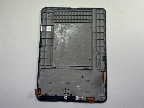

    1. Kindle Paperwhite (12th Gen) Screen Replacement, Screen: crwdns2935265:010crwdnd2935265:01crwdnd2935265:02crwdne2935265:0 Kindle Paperwhite (12th Gen) Screen Replacement, Screen: crwdns2935265:010crwdnd2935265:02crwdnd2935265:02crwdne2935265:0
      • Once you've removed the motherboard, this is what the screen looks like.
      • Install the motherboard and battery into the new screen casing, then reassemble the device in reverse order.
