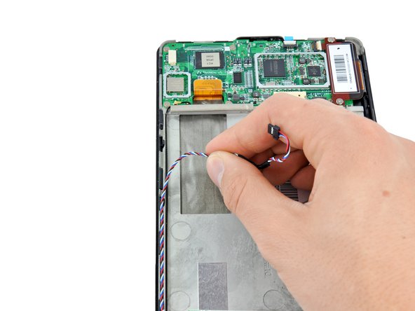

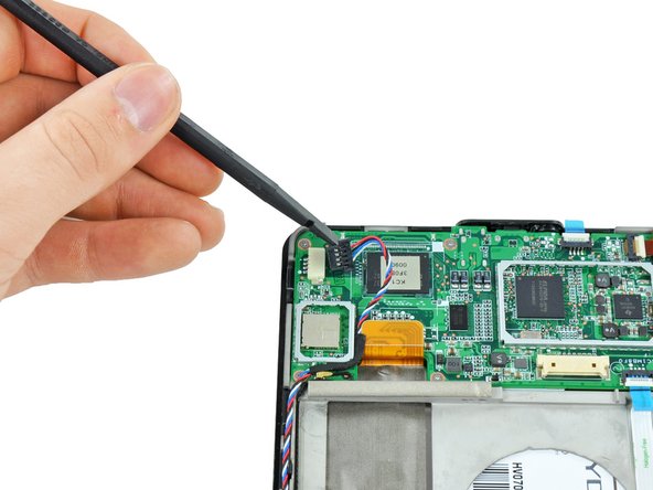

    1. Kindle Fire Motherboard Replacement, Speaker Cable: crwdns2935265:06crwdnd2935265:01crwdnd2935265:03crwdne2935265:0 Kindle Fire Motherboard Replacement, Speaker Cable: crwdns2935265:06crwdnd2935265:02crwdnd2935265:03crwdne2935265:0 Kindle Fire Motherboard Replacement, Speaker Cable: crwdns2935265:06crwdnd2935265:03crwdnd2935265:03crwdne2935265:0
      • Peel the tape on the upper-left IC that is securing the speaker cable.
      • Use the flat end of a spudger to push the speaker connector out of its socket.
      • Deroute the speaker cable so that it will not interfere with the motherboard.
