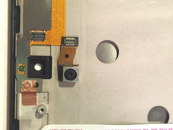

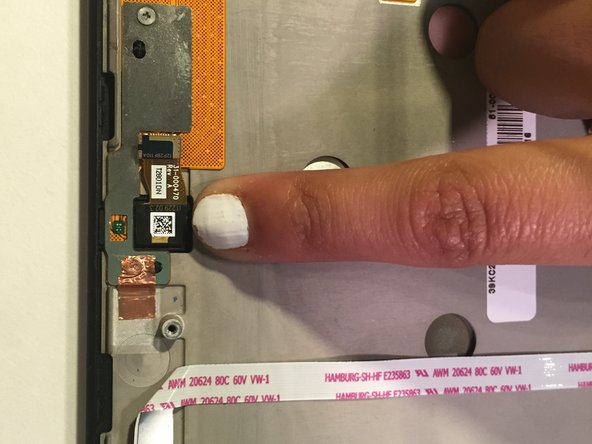

  7. Kindle Fire HD Front Facing Camera Replacement, Front Facing Camera: crwdns2935265:07crwdnd2935265:01crwdnd2935265:02crwdne2935265:0 Kindle Fire HD Front Facing Camera Replacement, Front Facing Camera: crwdns2935265:07crwdnd2935265:02crwdnd2935265:02crwdne2935265:0
    • After removing the battery, locate the camera.
  8. Kindle Fire HD Front Facing Camera Replacement: crwdns2935265:08crwdnd2935265:01crwdnd2935265:02crwdne2935265:0 Kindle Fire HD Front Facing Camera Replacement: crwdns2935265:08crwdnd2935265:02crwdnd2935265:02crwdne2935265:0
    • Use the plastic opening tool to carefully lift the camera up.
    • Now you may lift the camera out of your device.
