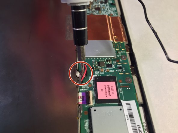

  5. Kindle Fire HD Battery Replacement, Detach Cable: crwdns2935265:05crwdnd2935265:01crwdnd2935265:02crwdne2935265:0 Kindle Fire HD Battery Replacement, Detach Cable: crwdns2935265:05crwdnd2935265:02crwdnd2935265:02crwdne2935265:0
    • Detach the plastic piece that connects the wires to the motherboard using the plastic opening tool.

Help. During our removal of the battery, the red and black wires that run along the long edge of the battery pulled free of their plug. Now we can't get them reattached. Not sure about polarity either.
