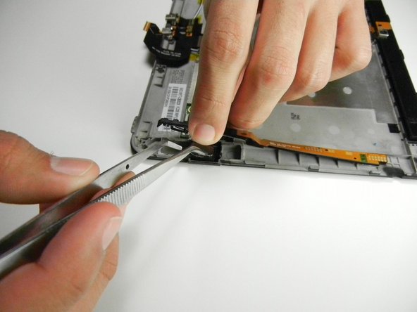

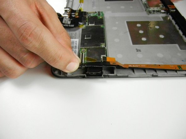

  10. Kindle Fire HD 8.9" Speakers Replacement, Speakers: crwdns2935265:010crwdnd2935265:01crwdnd2935265:01crwdne2935265:0
    • Looking back at the Kindle before the battery was removed, locate the the two speakers on the top and bottom.
    • We will be starting with the right (bottom) speaker.

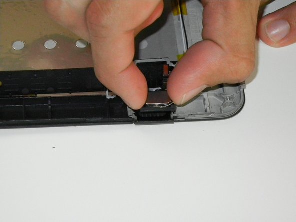

  11. Kindle Fire HD 8.9" Speakers Replacement: crwdns2935265:011crwdnd2935265:01crwdnd2935265:03crwdne2935265:0 Kindle Fire HD 8.9" Speakers Replacement: crwdns2935265:011crwdnd2935265:02crwdnd2935265:03crwdne2935265:0 Kindle Fire HD 8.9" Speakers Replacement: crwdns2935265:011crwdnd2935265:03crwdnd2935265:03crwdne2935265:0
    • With a plastic opening tool, pry along the top edge of the plastic casing.
    • Prying will be difficult considering the liberal amount of adhesive used to keep the casing in place. Don't give up.
    • Inside the casing is a small rectangular silver component. This is the speaker.
    • Pay attention to the orientation of the speaker.
    • Using pliers and enough force, pull the speaker upward and out of the casing. Once again adhesive may prove difficult.

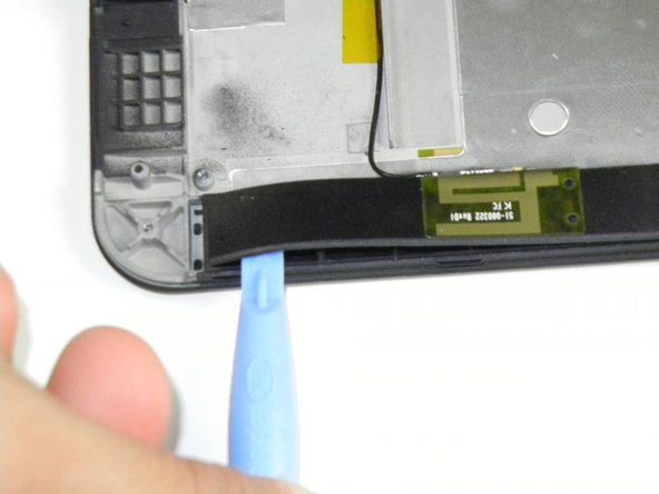

  12. Kindle Fire HD 8.9" Speakers Replacement: crwdns2935265:012crwdnd2935265:01crwdnd2935265:02crwdne2935265:0 Kindle Fire HD 8.9" Speakers Replacement: crwdns2935265:012crwdnd2935265:02crwdnd2935265:02crwdne2935265:0
    • To get to the left speaker use a plastic opening tool and pry open the plastic casing.
    • We recommend starting at the edge furthest from the speaker because there is less adhesive.
    • Move along the edge, forcing the opening tool in further and prying the two sections apart.
    • Don't be afraid to use force as the casing is flexible.
  13. Kindle Fire HD 8.9" Speakers Replacement: crwdns2935265:013crwdnd2935265:01crwdnd2935265:02crwdne2935265:0 Kindle Fire HD 8.9" Speakers Replacement: crwdns2935265:013crwdnd2935265:02crwdnd2935265:02crwdne2935265:0
    • Continue to move the opening tool along the edge until the entire casing is open.
    • Around the speaker is an extensive amount of adhesive (the white ribbons) and will require more force to separate.
    • Once the left speaker is accessible, use your fingers or some tweezers to pull the speaker upward and out.
    • Again there will be adhesive to make the process that much more enjoyable. Who doesn't like a challenge?
