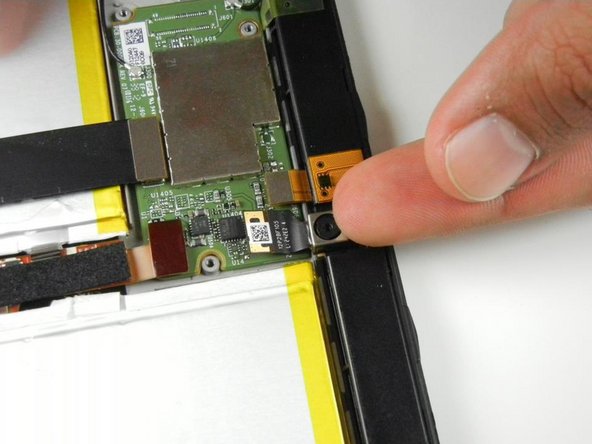

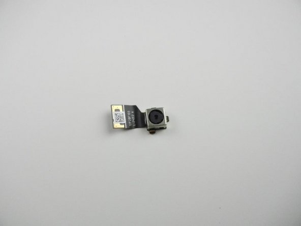

  7. Kindle Fire HD 8.9" Camera Replacement, Camera: crwdns2935265:07crwdnd2935265:01crwdnd2935265:03crwdne2935265:0 Kindle Fire HD 8.9" Camera Replacement, Camera: crwdns2935265:07crwdnd2935265:02crwdnd2935265:03crwdne2935265:0 Kindle Fire HD 8.9" Camera Replacement, Camera: crwdns2935265:07crwdnd2935265:03crwdnd2935265:03crwdne2935265:0
    • After taking off the metal casing, locate the camera.
    • Use your index finger to carefully lift up the silver clip located just under the camera. It will click when it comes loose.
    • After you snap up the silver clip, move your finger to the opposite side so that you are now pointing into the Kindle.
    • Push the camera outwards towards the edge of the device in order to remove it.
    • Make sure to keep the parts in a safe area to avoid any damage to the camera and its lens.
