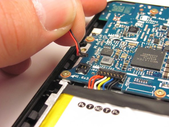

    • Unclip the speaker wire that runs up the side of the battery and clips into the motherboard next to the battery connector. Gently pull it straight up.

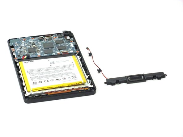

    • Lift the speaker out of the device.
