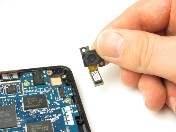

  3. Kindle Fire HD 6 Rear Facing Camera Replacement, Rear Facing Camera: crwdns2935265:03crwdnd2935265:01crwdnd2935265:01crwdne2935265:0
    • Unscrew the two 3.5mm T5 Torx Screws from the top of the camera.
  4. Kindle Fire HD 6 Rear Facing Camera Replacement: crwdns2935265:04crwdnd2935265:01crwdnd2935265:03crwdne2935265:0 Kindle Fire HD 6 Rear Facing Camera Replacement: crwdns2935265:04crwdnd2935265:02crwdnd2935265:03crwdne2935265:0 Kindle Fire HD 6 Rear Facing Camera Replacement: crwdns2935265:04crwdnd2935265:03crwdnd2935265:03crwdne2935265:0
    • Be careful not to damage the camera lens as you remove the camera.
    • Gently pull the camera up and out of the device. As you pull, unclip the black and white connector with orange tape by popping it off at its base.
