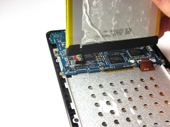

    1. Kindle Fire HD 6 Motherboard Replacement, Battery: crwdns2935265:08crwdnd2935265:01crwdnd2935265:01crwdne2935265:0
      iOpener
      $14.95
      • Gently pry the battery free from the adhesive holding it in place.
      • Take care not to pierce or rupture the battery, which can release dangerous chemicals.
      • If you're having trouble working the battery free, warm it up with an iOpener or hair dryer to soften the adhesive, and then slide a credit card behind the battery to break up the adhesive.
      • Be careful not to yank the battery out—you'll need to disconnect a connector before removing the battery completely.
    2. Kindle Fire HD 6 Motherboard Replacement: crwdns2935265:09crwdnd2935265:01crwdnd2935265:02crwdne2935265:0 Kindle Fire HD 6 Motherboard Replacement: crwdns2935265:09crwdnd2935265:02crwdnd2935265:02crwdne2935265:0
      • Remove the multi-colored connector that joins the battery and the motherboard by pulling it straight up.
      • Remove the battery.

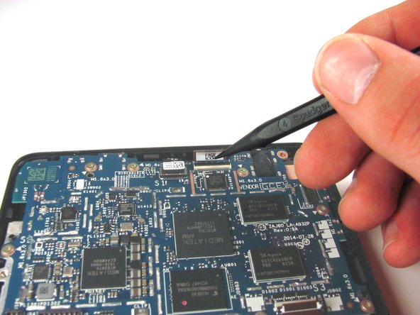

    1. Kindle Fire HD 6 Motherboard Replacement, Motherboard: crwdns2935265:010crwdnd2935265:01crwdnd2935265:02crwdne2935265:0 Kindle Fire HD 6 Motherboard Replacement, Motherboard: crwdns2935265:010crwdnd2935265:02crwdnd2935265:02crwdne2935265:0
      • Zero insertion force connectors can break easily. Before performing this step, read the iFixit Guide to Recognizing and Disconnecting Cable Connectors to find out how to safely remove them.
      • Use the tip of the spudger to disconnect the two zero insertion force connectors on the bottom and top of the motherboard.
      • The first connector is attached to an orange tape, and is located in the bottom-right corner of the motherboard. Remove this connector.
      • The second connector is long and thin, and is located at the top of the motherboard, a bit to the right of center. Remove this connector.

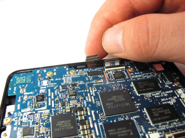

    2. Kindle Fire HD 6 Motherboard Replacement: crwdns2935265:011crwdnd2935265:01crwdnd2935265:02crwdne2935265:0 Kindle Fire HD 6 Motherboard Replacement: crwdns2935265:011crwdnd2935265:02crwdnd2935265:02crwdne2935265:0
      • Disconnect the black and white connector at the very top-center of the motherboard by unclipping it using the flat side of the spudger.

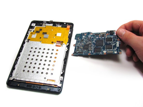

    3. Kindle Fire HD 6 Motherboard Replacement: crwdns2935265:012crwdnd2935265:01crwdnd2935265:01crwdne2935265:0
      • Unscrew the ten 3.5mm T5 Torx screws around the edge of the motherboard.
    4. Kindle Fire HD 6 Motherboard Replacement: crwdns2935265:013crwdnd2935265:01crwdnd2935265:02crwdne2935265:0 Kindle Fire HD 6 Motherboard Replacement: crwdns2935265:013crwdnd2935265:02crwdnd2935265:02crwdne2935265:0
      • Starting from the bottom, lift the motherboard out of the device. You will have to push the motherboard about two millimeters toward the top of the device to unhook the top edge.
