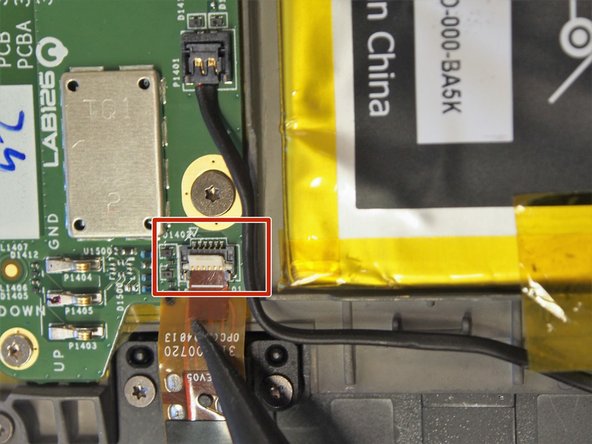

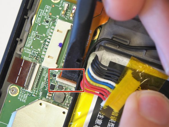

    • Locate the battery's power ribbon.
    • Use a nylon spudger to disconnect the ribbon from the motherboard.

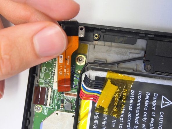

    • After locating the USB port at the top of the device, remove the (2) 3mm T4 Torx screws.
  4. Kindle Fire HD 2013 USB and Aux Port Replacement: crwdns2935265:04crwdnd2935265:01crwdnd2935265:03crwdne2935265:0 Kindle Fire HD 2013 USB and Aux Port Replacement: crwdns2935265:04crwdnd2935265:02crwdnd2935265:03crwdne2935265:0 Kindle Fire HD 2013 USB and Aux Port Replacement: crwdns2935265:04crwdnd2935265:03crwdnd2935265:03crwdne2935265:0
    • After removing the screws, follow the ribbon to where it connects to the main device.
    • There is a small tab here that must be lifted up in order to allow the ribbon to be removed without damaging it.
    • Once the tab has been opened, gently pull the ribbon out and away. The USB port should now be detached completely.

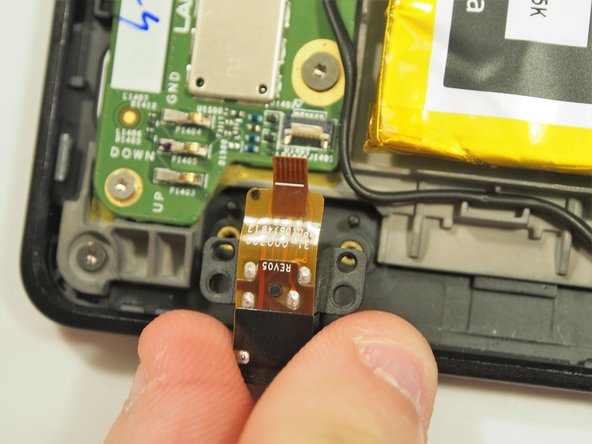

    • After locating the Aux port at the bottom of the device, remove the (2) 3mm T4 Torx screws.
  6. Kindle Fire HD 2013 USB and Aux Port Replacement: crwdns2935265:06crwdnd2935265:01crwdnd2935265:03crwdne2935265:0 Kindle Fire HD 2013 USB and Aux Port Replacement: crwdns2935265:06crwdnd2935265:02crwdnd2935265:03crwdne2935265:0 Kindle Fire HD 2013 USB and Aux Port Replacement: crwdns2935265:06crwdnd2935265:03crwdnd2935265:03crwdne2935265:0
    • There is a tab here that must be opened before the part can be removed. Use the nylon spudger or a finger nail to lift the tab open.
    • Once the tab is open, gently remove the ribbon. The Aux port should now be detached completely.
