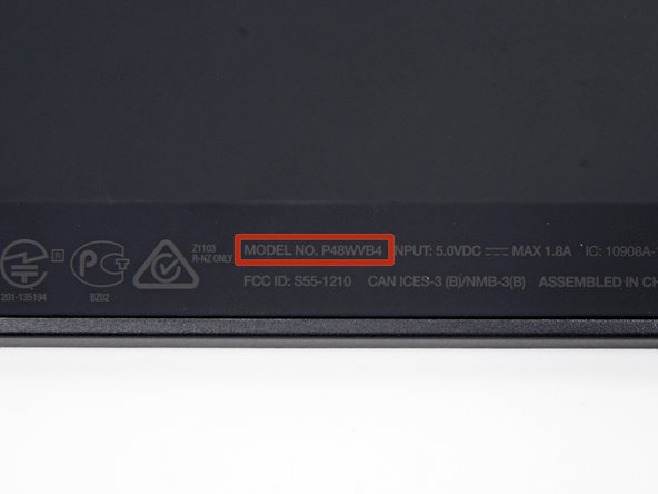

    • A quick glance at the rear case reveals Amazon's smiling facelogo and newly prominent power and volume buttons.
    • A quick close-up reveals the model number: P48WVB4.
    • Other findings include speaker grilles, power requirements, FCC info, and the standard "Made in China".

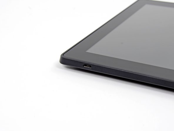

    • Ports! We've got ports! Get 'em while they're hot.
    • Headphone jack up top, Micro-USB on the bottom. Like the flounder, Amazon seems to be shifting its vitals around.
    • Contrasting last year's Fire HD, which had ports on the side and bottom, this year's port layout was assuredly driven by some internal component shifts. We look forward to finding out what they are!

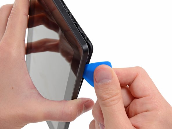

    • Despite the fiery name, we're happy to find we don't need heat to open this Kindle. So far, a plastic opening tool and an opening pick are all we need.
    • Heatless opening procedures make us all warm and fuzzy inside—it means that when your device loses its spark, you can keep your cool with easy repairs.

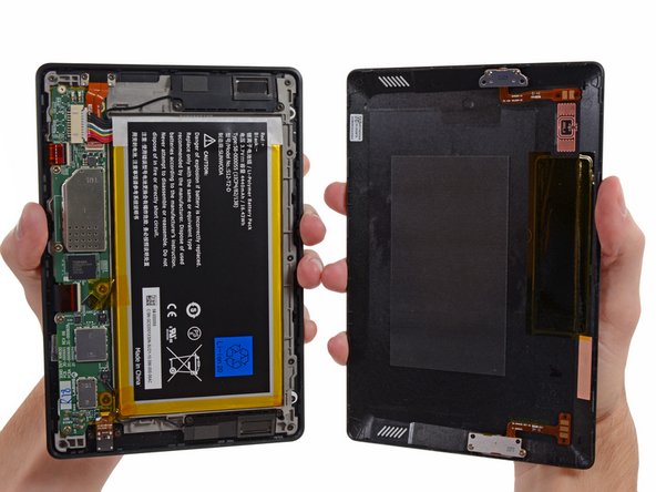

    • We made it! What do we have here?
    • Big battery: check.
    • Motherboard: check.
    • It looks like every tablet we've opened; let's see if we can find something a bit more interesting…

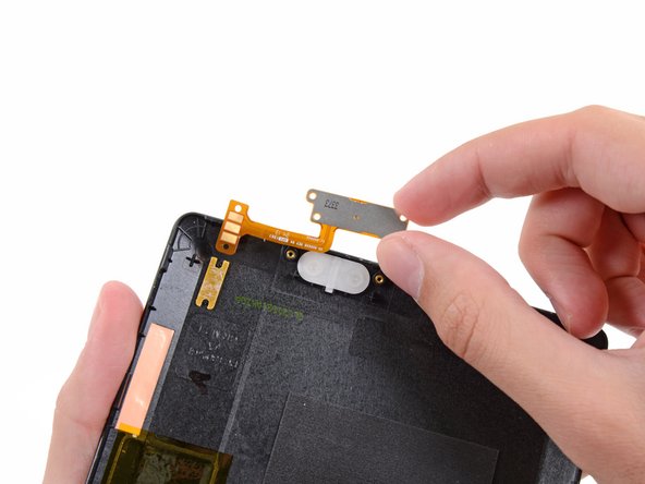

    • The volume buttons come out easily enough, once we liberate the volume bracket from the rear case.
    • The button assembly is hefty, which means we won't lose it and can replace it, even with our big meaty claws.

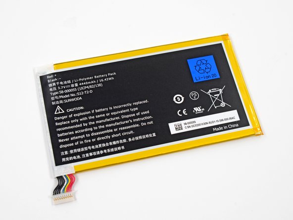

    • A reasonable amount of adhesive holds the battery in place; we make short work of it with some fancy spudgering.
    • Verdict: The battery is more replaceable than some of the tablets we encounter, but slim design still rules.
    • The 3.7 V, 4440 mAh battery boasts 10 hours of power during mixed usage—a decrease from the 2012 HD edition. Amazon calls it an increase in battery life compared to the "previous generation Kindle Fire."
    • Let us break it down for you: This HD is really the new Kindle Fire and the Kindle Fire HDX will be the new Kindle Fire HD. Confused yet?

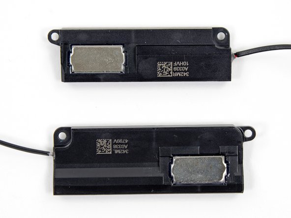

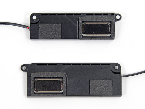

    • We pop out the dual speakers to see just what this Dolby Digital Plus speaker system is all about.
    • Not only does your tablet have virtual surround sound, but it has clarity-optimized sound, with or without headphones. So you can be creeped out by this barber shop experience even without your beets by Dr. Dre.

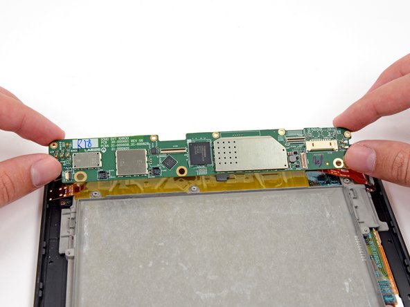

    • Some dainty spudgering and a few twists of our screwdriver, and the motherboard is free as the wind
    • …but not free enough. We still need to get under those pesky EMI shields and reveal the secrets nestled in this Kindle's brain.

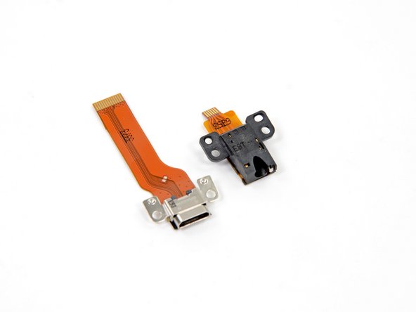

    • We love modularity. The separate and easily-removable headphone jack and Micro-USB connectors are exciting to find, especially compared to long strings of components that make repair pricier and more difficult.
