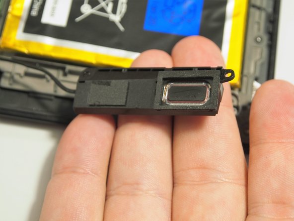

    • Open up the device by using a plastic opening tool in order to avoid damaging the device.
    • To do so, find the seam along the outer edge of the device and use the plastic tool to pry the back panel up. Doing so may take some force and patience.

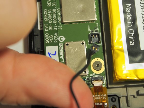

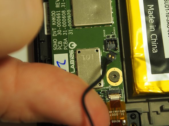

    • There are (4) 3mm T4 Torx screws between both speakers (two each). Remove the ones necessary for whichever speaker needs to be replaced.
  3. Kindle Fire HD 2013 Speakers Replacement: crwdns2935265:03crwdnd2935265:01crwdnd2935265:03crwdne2935265:0 Kindle Fire HD 2013 Speakers Replacement: crwdns2935265:03crwdnd2935265:02crwdnd2935265:03crwdne2935265:0 Kindle Fire HD 2013 Speakers Replacement: crwdns2935265:03crwdnd2935265:03crwdnd2935265:03crwdne2935265:0
    • After the screws are removed, locate the wire, follow it to where it connects to the main device, and pull up gently until it disconnects.

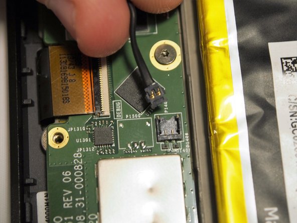

    • Remove (2) 3mm T4 Torx screws from the bottom speaker.
  5. Kindle Fire HD 2013 Speakers Replacement: crwdns2935265:05crwdnd2935265:01crwdnd2935265:02crwdne2935265:0 Kindle Fire HD 2013 Speakers Replacement: crwdns2935265:05crwdnd2935265:02crwdnd2935265:02crwdne2935265:0
    • Same as Step 3, after the screws are removed, follow the wire to where it connects and pull up gently until it disconnects.
