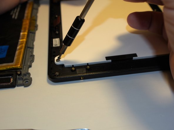

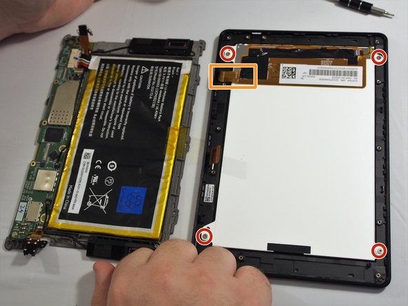

      • Once the screws and ribbons are removed, use the nylon spudger to gently remove the plate holding the rest of the components and set to the side.
      • Once the plate has been removed, located the (4) 3mm T4 Torx screws and remove them.
      • There is a single ribbon here that has to be removed as well. Follow the ribbon to where it connects. Gently lift the tab using the spudger or a fingernail. Once the tab is open, gently pull the ribbon out and away.

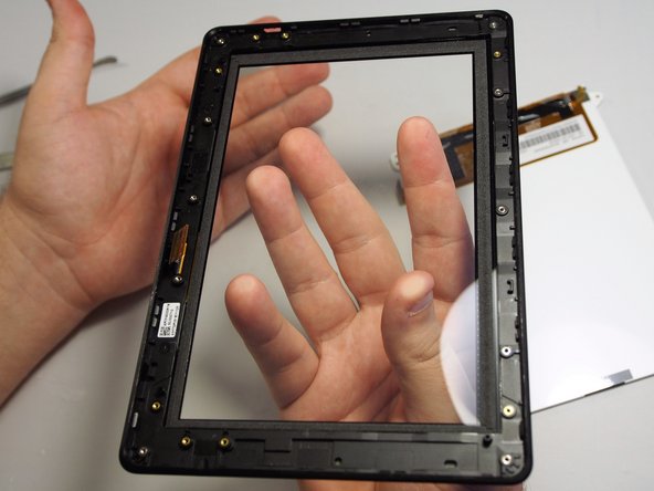

    6. Kindle Fire HD 2013 Screen Replacement: crwdns2935265:06crwdnd2935265:01crwdnd2935265:02crwdne2935265:0 Kindle Fire HD 2013 Screen Replacement: crwdns2935265:06crwdnd2935265:02crwdnd2935265:02crwdne2935265:0
      • Once the ribbon and screws are removed, pick the part up and tilt it into your other hand. The touch screen component and the clear cover should now be disconnected completely.
