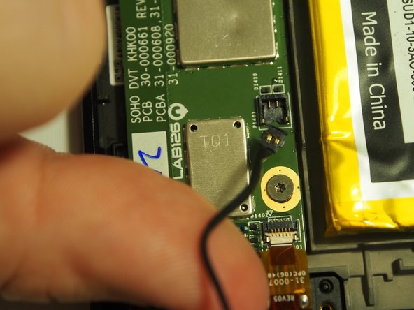

    • Locate the battery's power ribbon.
    • Use the nylon spudger to disconnect the ribbon from the mother board.

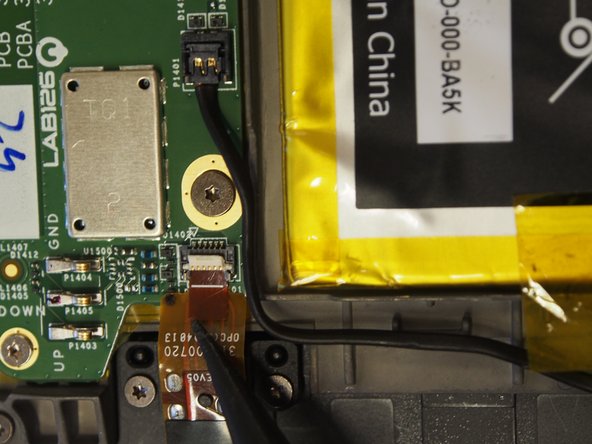

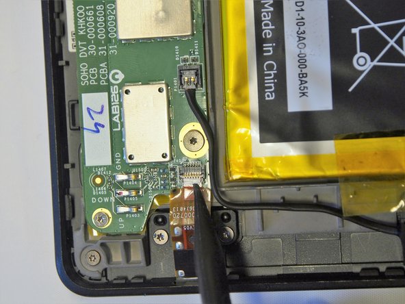

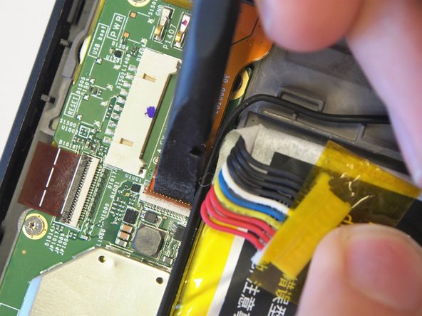

    • Identify the ribbon at the top left of the tablet.
    • Use a nylon spudger to lift the black tab holding the ribbon.

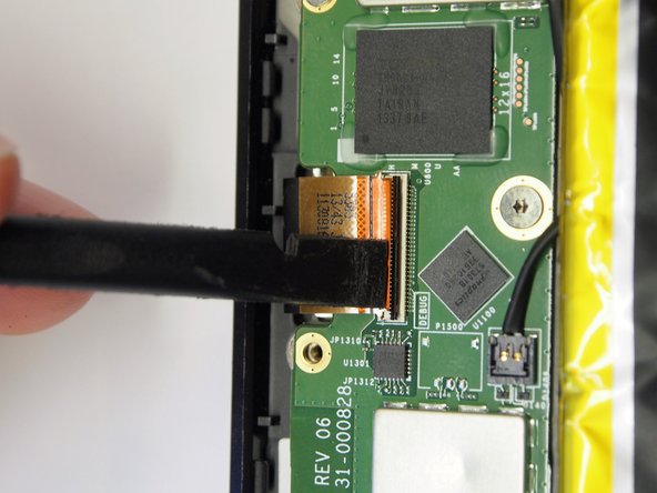

  4. Kindle Fire HD 2013 Motherboard Replacement: crwdns2935265:04crwdnd2935265:01crwdnd2935265:01crwdne2935265:0
    • Pull the ribbon out of the motherboard.

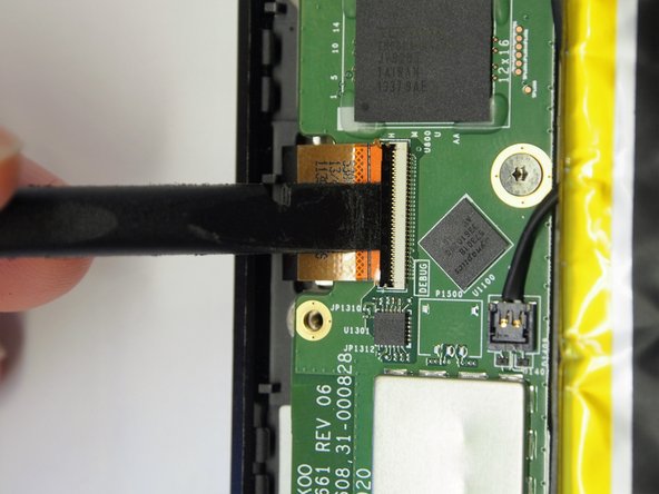

    • Identify the ribbon located at the center left of the motherboard.
    • Using the black spudger, lift up the black tab holding it in place.
  6. Kindle Fire HD 2013 Motherboard Replacement: crwdns2935265:06crwdnd2935265:01crwdnd2935265:01crwdne2935265:0

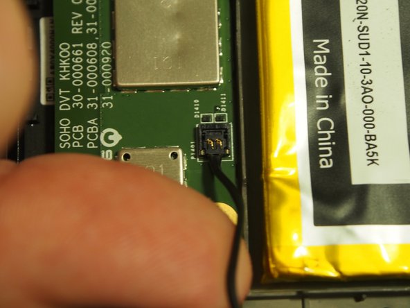

    • Identify the 2 black contacts for the speakers.
    • Pull straight up near the connection point and the wire will come disconnect easily.

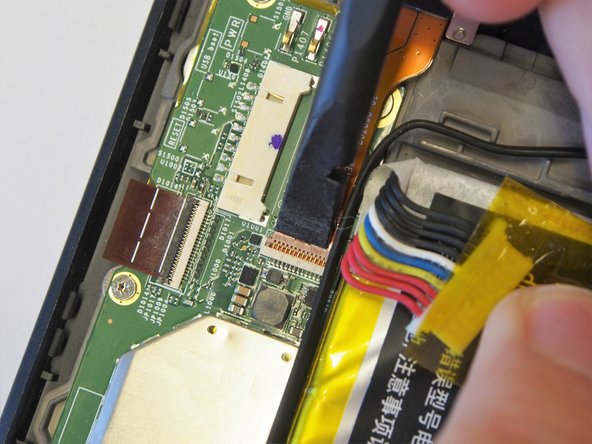

    • Identify the ribbon at the bottom of the motherboard for the headphone jack.
    • Using the nylon spudger, lift up the white tab holding the ribbon in place.
  10. Kindle Fire HD 2013 Motherboard Replacement: crwdns2935265:010crwdnd2935265:01crwdnd2935265:01crwdne2935265:0
    • Pull out the ribbon from the motherboard.
