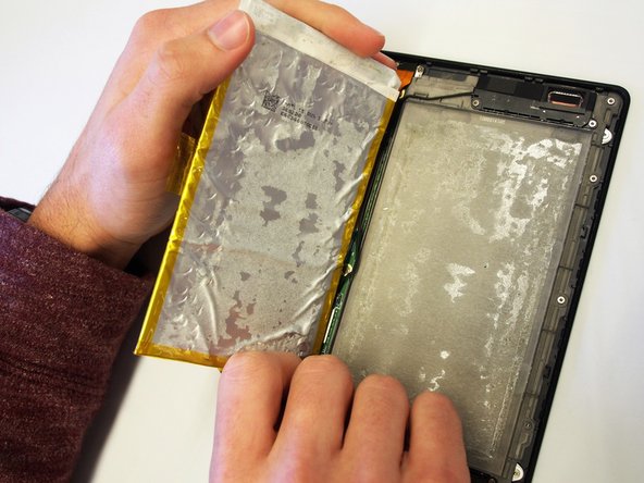

    • Peel battery away.
    • Battery is glued and may cause permanent damage if bent.
