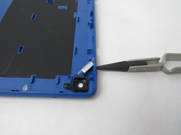

  2. Kindle Fire HD 10 Sound and Power Button Replacement: crwdns2935265:02crwdnd2935265:01crwdnd2935265:02crwdne2935265:0 Kindle Fire HD 10 Sound and Power Button Replacement: crwdns2935265:02crwdnd2935265:02crwdnd2935265:02crwdne2935265:0
    • Power and Sound Buttons can be found on the top of the device.

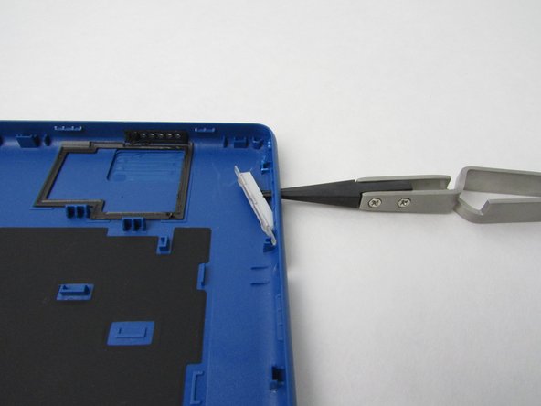

  3. Kindle Fire HD 10 Sound and Power Button Replacement: crwdns2935265:03crwdnd2935265:01crwdnd2935265:02crwdne2935265:0 Kindle Fire HD 10 Sound and Power Button Replacement: crwdns2935265:03crwdnd2935265:02crwdnd2935265:02crwdne2935265:0
    • Push out the sound button with the tweezers gently.
    • Use tweezers to then remove the button.

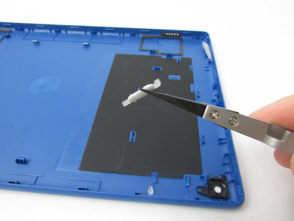

  4. Kindle Fire HD 10 Sound and Power Button Replacement: crwdns2935265:04crwdnd2935265:01crwdnd2935265:03crwdne2935265:0 Kindle Fire HD 10 Sound and Power Button Replacement: crwdns2935265:04crwdnd2935265:02crwdnd2935265:03crwdne2935265:0 Kindle Fire HD 10 Sound and Power Button Replacement: crwdns2935265:04crwdnd2935265:03crwdnd2935265:03crwdne2935265:0
    • Use tweezers to remove and pick up the button carefully.
