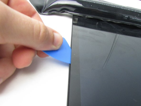

    • Heat up an iOpener (or use a heatgun) and apply it along the edges of the screen.
    • Begin to pry open the edges of the screen carefully using an opening pick.
    • It may help to pry open the edges first.
  5. Kindle Fire HD 10 Screen Replacement: crwdns2935265:05crwdnd2935265:01crwdnd2935265:02crwdne2935265:0 Kindle Fire HD 10 Screen Replacement: crwdns2935265:05crwdnd2935265:02crwdnd2935265:02crwdne2935265:0

STEP 4 - if using heat gun, use low heat and heat evenly. heat up the flex a little before transferring.
STEP 5 - I used 2 sided tape to replace the stock adhesive

Never mind gorilla glass -- Amazon used gorilla glue all around the screen/digitizer. In an hour of alternate heatgun, razor, and pry tool work, I got one corner and about 10cm of one edge free. An Amazon-refurbished tablet goes for $60-$75; unless you value your time (and curses) very little, I can't recommend this project.
