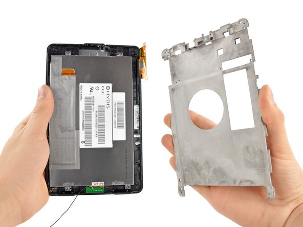

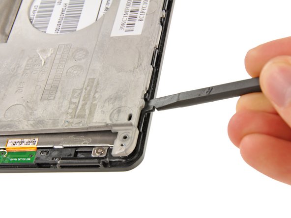

    1. Kindle Fire Frame Replacement, Frame: crwdns2935265:018crwdnd2935265:01crwdnd2935265:03crwdne2935265:0 Kindle Fire Frame Replacement, Frame: crwdns2935265:018crwdnd2935265:02crwdnd2935265:03crwdne2935265:0 Kindle Fire Frame Replacement, Frame: crwdns2935265:018crwdnd2935265:03crwdnd2935265:03crwdne2935265:0
      • Use the flat end of a spudger to lever the frame away from the display assembly until you can grab it with your hand.
      • Lift near the retaining tabs marked by red rectangles in the first picture.
      • Remove the frame from the display assembly.
      • While removing the frame there may be sticky residue that will generate some resistance to the detachment of the top half of the frame.
