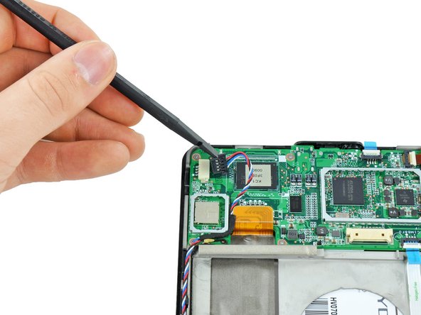

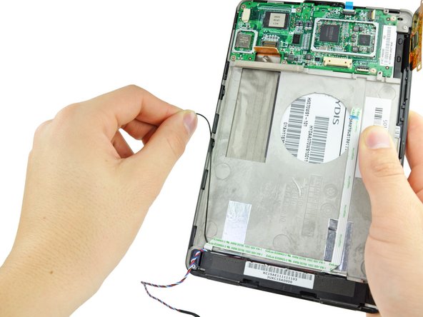

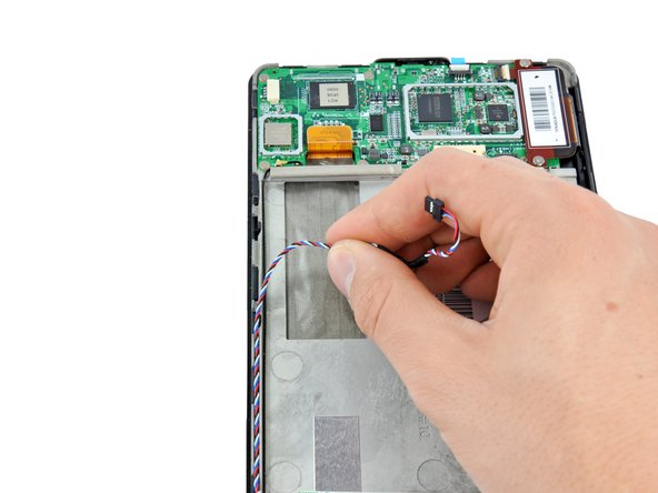

  6. Kindle Fire Ambient Light Sensor Replacement, Speaker Assembly: crwdns2935265:06crwdnd2935265:01crwdnd2935265:03crwdne2935265:0 Kindle Fire Ambient Light Sensor Replacement, Speaker Assembly: crwdns2935265:06crwdnd2935265:02crwdnd2935265:03crwdne2935265:0 Kindle Fire Ambient Light Sensor Replacement, Speaker Assembly: crwdns2935265:06crwdnd2935265:03crwdnd2935265:03crwdne2935265:0
    • Peel the tape on the upper-left IC that is securing the speaker cable.
    • Use the flat end of a spudger to push the speaker connector out of its socket.
    • Deroute the speaker cable.

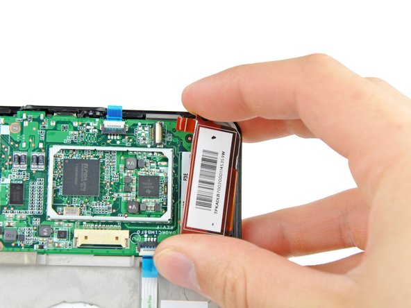

  8. Kindle Fire Ambient Light Sensor Replacement, Motherboard: crwdns2935265:08crwdnd2935265:01crwdnd2935265:03crwdne2935265:0 Kindle Fire Ambient Light Sensor Replacement, Motherboard: crwdns2935265:08crwdnd2935265:02crwdnd2935265:03crwdne2935265:0 Kindle Fire Ambient Light Sensor Replacement, Motherboard: crwdns2935265:08crwdnd2935265:03crwdnd2935265:03crwdne2935265:0
    • Remove the two 2.3 mm Phillips #00 screws from the touchscreen controller.
    • Use a plastic opening tool to release the touchscreen controller connector.
    • Gently remove the touchscreen controller by lifting it up and to the right.
    • Be careful not to rip the ribbon cable in doing so.

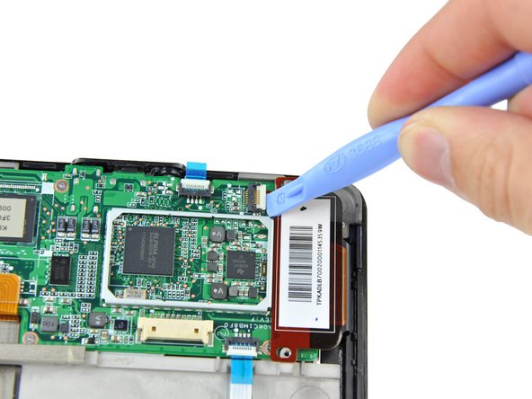

  9. Kindle Fire Ambient Light Sensor Replacement: crwdns2935265:09crwdnd2935265:01crwdnd2935265:03crwdne2935265:0 Kindle Fire Ambient Light Sensor Replacement: crwdns2935265:09crwdnd2935265:02crwdnd2935265:03crwdne2935265:0 Kindle Fire Ambient Light Sensor Replacement: crwdns2935265:09crwdnd2935265:03crwdnd2935265:03crwdne2935265:0
    • Use a plastic opening tool to flip open the power button ZIF connector.
    • This connector will not be removed until the motherboard is free.
    • Flip open the ambient light sensor ZIF socket with a plastic opening tool.
    • Use a pair of tweezers to pull the blue tab on the ambient light sensor cable to remove it from its socket.

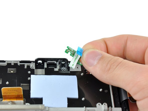

  17. Kindle Fire Ambient Light Sensor Replacement, Ambient Light Sensor: crwdns2935265:017crwdnd2935265:01crwdnd2935265:01crwdne2935265:0
    • Slide the ambient light sensor out from under the frame and remove it from the Kindle Fire.
    • If the ambient light sensor will not easily come out, slightly lift the frame with a plastic opening tool to allow it to come free.
