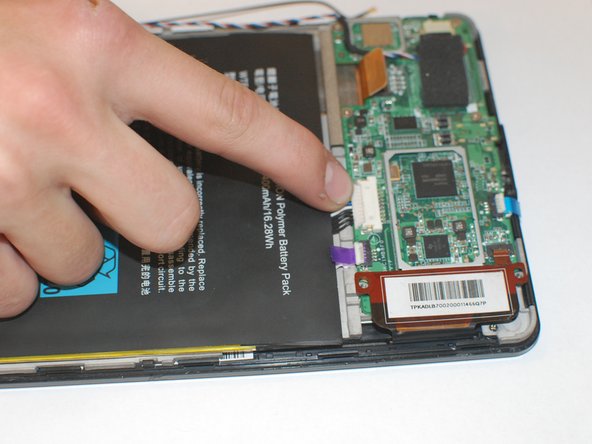

  2. Kindle Fire 1st Generation Motherboard Replacement, Locating Part Number: crwdns2935265:02crwdnd2935265:01crwdnd2935265:03crwdne2935265:0 Kindle Fire 1st Generation Motherboard Replacement, Locating Part Number: crwdns2935265:02crwdnd2935265:02crwdnd2935265:03crwdne2935265:0 Kindle Fire 1st Generation Motherboard Replacement, Locating Part Number: crwdns2935265:02crwdnd2935265:03crwdnd2935265:03crwdne2935265:0
    • The first photo shows two red circles over the screw that will need to be removed first.
    • After lifting the tab as shown in the third photo you will need the part number located below bar code.

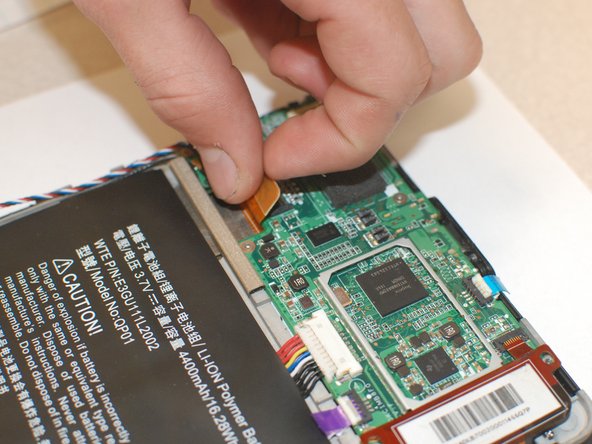

  3. Kindle Fire 1st Generation Motherboard Replacement, Remove All Tabs: crwdns2935265:03crwdnd2935265:01crwdnd2935265:01crwdne2935265:0
    • Next you will need remove all of the little white sliders that hold tabs down. if your fingernails are any shorter than mine you may need to use something for assistance.

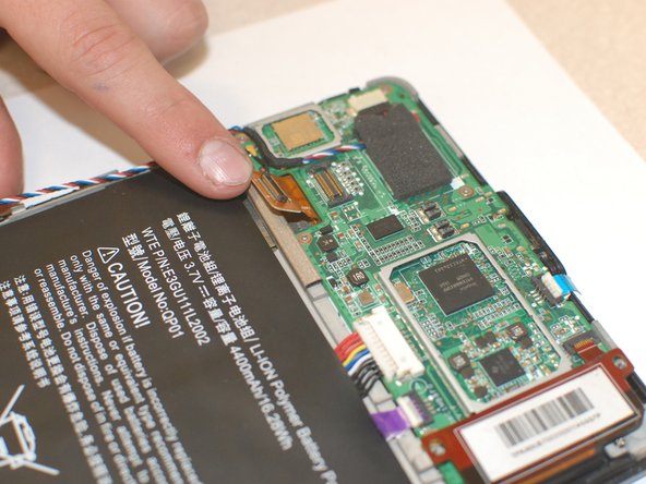

  4. Kindle Fire 1st Generation Motherboard Replacement, Remove All Wires: crwdns2935265:04crwdnd2935265:01crwdnd2935265:03crwdne2935265:0 Kindle Fire 1st Generation Motherboard Replacement, Remove All Wires: crwdns2935265:04crwdnd2935265:02crwdnd2935265:03crwdne2935265:0 Kindle Fire 1st Generation Motherboard Replacement, Remove All Wires: crwdns2935265:04crwdnd2935265:03crwdnd2935265:03crwdne2935265:0
    • Remove all of the wires that trace to the mother board.
    • Two speaker wires
    • Wire for battery
