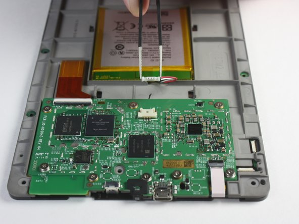

    • Flip the screen over to face the motherboard and battery pack.
    • Use the blunted precision tweezers to gently unclip and detach the cable connecting the battery pack and motherboard.

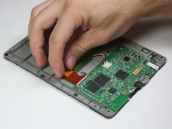

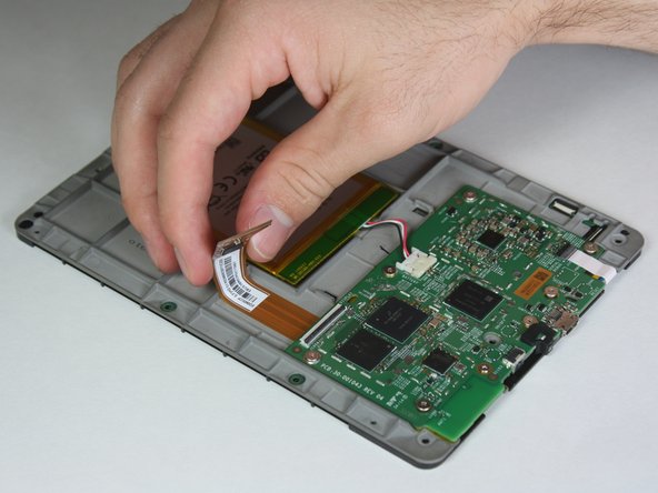

    • Use the tip of the spudger to flip up the small retaining flap on the copper colored zero insertion force (ZIF) connector.
    • Make sure to flip up the flap and not the connection itself.
    • Pull the cable from the connector.
    • No force is required to do this, as the name, ZIF, implies.

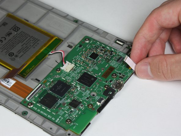

    • Similar to the previous step, flip up the retaining flap on the white cable connector.
    • Pull the white cable from the connection.
    • During reassembly, make sure the retaining flaps for both the white and copper colored cable connections are secured. As these are zero insertion force connections, the cables could potentially slide out if this is not done.

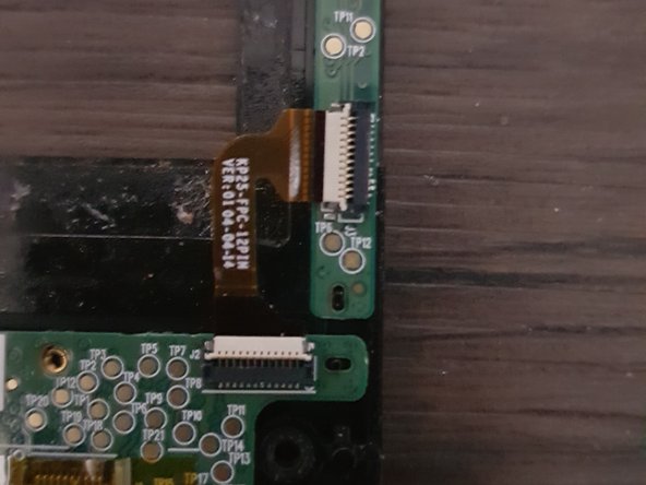

    • Disconnect the touch digitiser bridge cable by using your Spudger to lift up the white tabs on both connectors.
    • Use tweezers to pull out the cable.
    • The touch digitiser bridge cable is the one connecting between these two connectors.

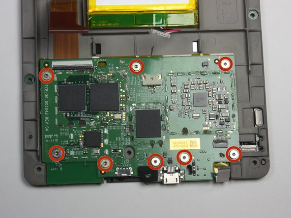

    • Use the T5 Torx screwdriver to remove the eight 3.0 mm Torx screws.
    • Some screws have washers associated with them. It is important to keep track of the washers and remember which thread they came from.
  10. Kindle 7th Generation Motherboard Replacement: crwdns2935265:010crwdnd2935265:01crwdnd2935265:01crwdne2935265:0
    • Remove the motherboard.

This doesn’t look like my 7th generation. Close but not quite the same. Does the motherboard have to be removed to replace the screen?

yes this is Def not the same as my 7th gen but it's an 8 inch so maybe that's the difference.. all I see is 4 screws holding down the motherboard n I've removed them but still can't get the board loose.. it's like one side of it is held down under these plastic tabs that don't move..
