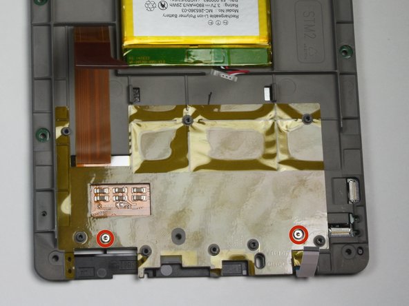

    1. Kindle 7th Generation LED Circuit Board Replacement, LED Circuit Board: crwdns2935265:011crwdnd2935265:01crwdnd2935265:02crwdne2935265:0 Kindle 7th Generation LED Circuit Board Replacement, LED Circuit Board: crwdns2935265:011crwdnd2935265:02crwdnd2935265:02crwdne2935265:0
      • Remove the two 2.5 mm Torx screws using the T5 Torx screwdriver.
