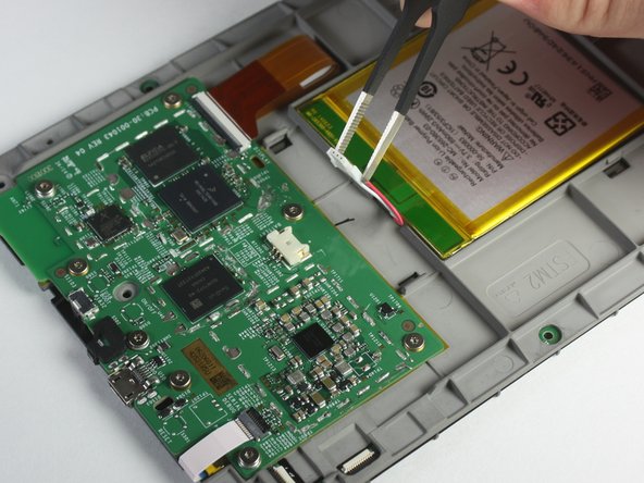

    1. Kindle 7th Generation Battery Replacement, Battery: crwdns2935265:05crwdnd2935265:01crwdnd2935265:01crwdne2935265:0
      • Flip the Kindle over, exposing the battery and motherboard.
    2. Kindle 7th Generation Battery Replacement: crwdns2935265:06crwdnd2935265:01crwdnd2935265:02crwdne2935265:0 Kindle 7th Generation Battery Replacement: crwdns2935265:06crwdnd2935265:02crwdnd2935265:02crwdne2935265:0
      • Use the blunted precision tweezers to pinch the ends of the clip securing the battery cord to the motherboard.
      • Gently slide the cord from the motherboard connection.
    3. Kindle 7th Generation Battery Replacement: crwdns2935265:07crwdnd2935265:01crwdnd2935265:03crwdne2935265:0 Kindle 7th Generation Battery Replacement: crwdns2935265:07crwdnd2935265:02crwdnd2935265:03crwdne2935265:0 Kindle 7th Generation Battery Replacement: crwdns2935265:07crwdnd2935265:03crwdnd2935265:03crwdne2935265:0
      • Use the plastic opening tool to pry the battery from the backside of the screen.
      • Set the battery aside.
      • The battery has excessive adhesive so this may take some extra effort. See picture of battery deformed by prying tool during removal.
      • If replacing your battery, safely dispose of your damaged battery and use adhesive to insert the new battery.

Fairly easy to do. Saves a lot of money compared to buying a whole new Kindle :) Thank you for this! A note: I've never seen batteries as...soft as these. Take care when using the removal tool. I could be easy to puncture the battery which could cause a big mess and possibly injury.
Joshua - crwdns2934203:0crwdne2934203:0 crwdns2950251:0crwdne2950251:0
My old battery got seriously deformed during removal, but didn't puncture or tear. I added a picture to the guide, so that hopefully the next person is not as alarmed as I was :)
Nathan T - crwdns2934203:0crwdne2934203:0 crwdns2950251:0crwdne2950251:0
