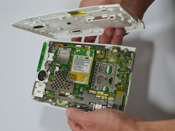

  3. Kindle 1st Generation Screen Replacement, SD Card Reader: crwdns2935265:03crwdnd2935265:01crwdnd2935265:01crwdne2935265:0
    • Unscrew eight (8) Phillips #00 screws (3 mm).
  4. Kindle 1st Generation Screen Replacement: crwdns2935265:04crwdnd2935265:01crwdnd2935265:02crwdne2935265:0 Kindle 1st Generation Screen Replacement: crwdns2935265:04crwdnd2935265:02crwdnd2935265:02crwdne2935265:0
    • Start at one side of the device. Use a plastic opening tool to separate the casing of the device. Slowly work your way around the entire device.
    • Avoid prying between the buttons and the device. This could cause damage to the buttons.

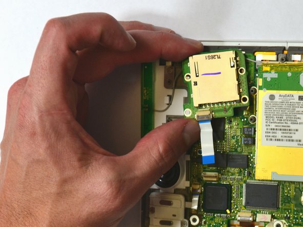

  6. Kindle 1st Generation Screen Replacement: crwdns2935265:06crwdnd2935265:01crwdnd2935265:01crwdne2935265:0
    • Remove the four (4) Phillips #00 screws (3 mm) which fasten the SD Card Reader.
  7. Kindle 1st Generation Screen Replacement: crwdns2935265:07crwdnd2935265:01crwdnd2935265:02crwdne2935265:0 Kindle 1st Generation Screen Replacement: crwdns2935265:07crwdnd2935265:02crwdnd2935265:02crwdne2935265:0
    • Lift the flap attaching the blue and white ribbon cable to the motherboard by lifting it vertically with a spudger.
    • The flap is connected via a hinge. Once you lift the flap, it will stay up and the cable will be lose. Remember to snap it back down during reassembly.
    • Carefully lift the SD Card Reader vertically from the motherboard.

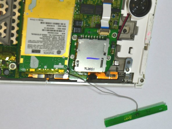

    • Use a spudger to remove the Wifi antenna from the device by carefully prying it up off the casing.
    • The Wifi antenna is attached to the device by a mild adhesive. Once the antenna is free from the adhesive, set the antenna off to the side.
    • Do not try to detach the antenna from the motherboard.

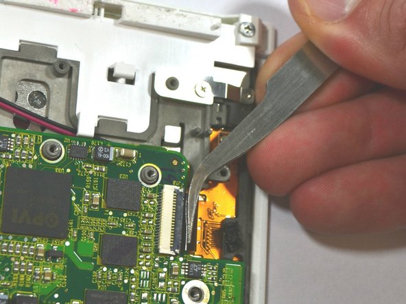

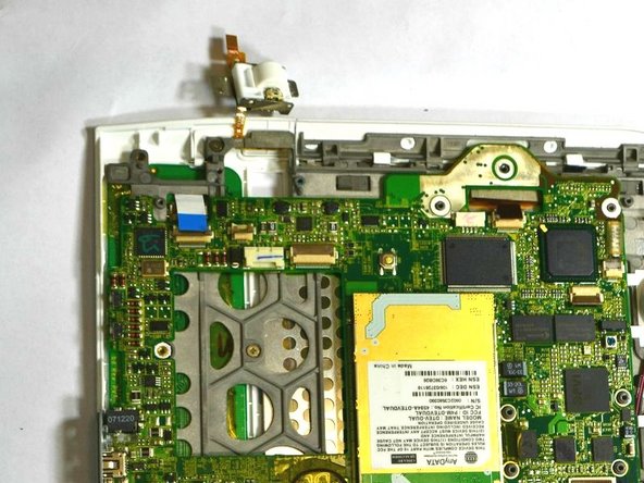

  12. Kindle 1st Generation Screen Replacement: crwdns2935265:012crwdnd2935265:01crwdnd2935265:03crwdne2935265:0 Kindle 1st Generation Screen Replacement: crwdns2935265:012crwdnd2935265:02crwdnd2935265:03crwdne2935265:0 Kindle 1st Generation Screen Replacement: crwdns2935265:012crwdnd2935265:03crwdnd2935265:03crwdne2935265:0
    • Lift the flap attaching the blue and white ribbon cable to the motherboard by lifting it vertically with the spudger.
    • Lift the flap with the pointed-end of the spudger to detach the ribbon cable indicated in the second image.
    • The flaps are connected via a hinge. Once you lift the flap, it will stay up and the cable will be lose. Remember to snap it back down during reassembly.
    • Use tweezers to pull the ribbon cable in the third image laterally to detach it.

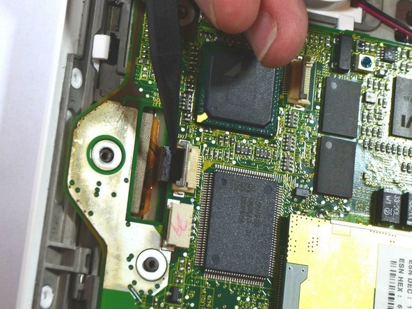

  13. Kindle 1st Generation Screen Replacement: crwdns2935265:013crwdnd2935265:01crwdnd2935265:01crwdne2935265:0
    • Detach the cable by pulling laterally with tweezers or your fingertips. Do this by grasping the edges of the white connector and pulling laterally.
    • Grasp the end of the cable with tweezers or your fingertips and pull upwards to detach it from the motherboard.
    • Do not grasp either cable by the wires and attempt to pull them.

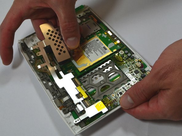

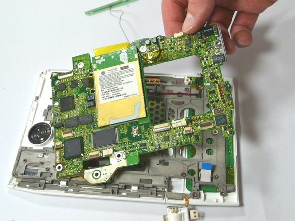

  14. Kindle 1st Generation Screen Replacement: crwdns2935265:014crwdnd2935265:01crwdnd2935265:03crwdne2935265:0 Kindle 1st Generation Screen Replacement: crwdns2935265:014crwdnd2935265:02crwdnd2935265:03crwdne2935265:0 Kindle 1st Generation Screen Replacement: crwdns2935265:014crwdnd2935265:03crwdnd2935265:03crwdne2935265:0
    • Remove the two (2) Phillips #00 screws (3 mm) which attach the motherboard to the front casing.
    • Carefully lift the motherboard off.
    • The piece marked in the third image may be loose and fall out freely. If it does not fall off, use your fingers or a plastic opening tool to snap it off. Make sure to place it under the motherboard during reassembly, as found in the image.

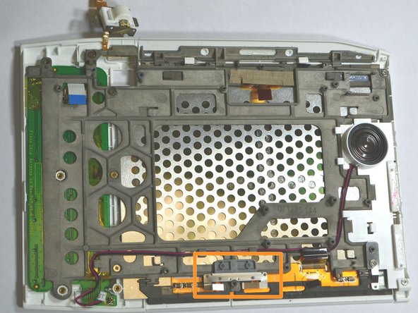

  15. Kindle 1st Generation Screen Replacement: crwdns2935265:015crwdnd2935265:01crwdnd2935265:01crwdne2935265:0
    • Remove the seven (7) Phillips #00 screws (3 mm) remaining on the frame.
    • The orange-marked metal piece is only held down by a screw and will become loose. Make sure to re-position it during assembly.

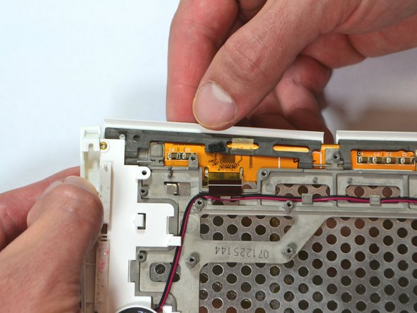

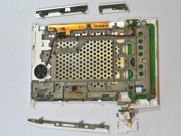

  16. Kindle 1st Generation Screen Replacement: crwdns2935265:016crwdnd2935265:01crwdnd2935265:02crwdne2935265:0 Kindle 1st Generation Screen Replacement: crwdns2935265:016crwdnd2935265:02crwdnd2935265:02crwdne2935265:0
    • Press down firmly on the two white tabs, behind the large 'NEXT PAGE' button with the spudger. This will unsnap the front casing from the rest of the device.
    • The front case will begin to come loose. Do not try to pull it off.
    • Slide out the large 'NEXT PAGE' button laterally away from the keyboard.

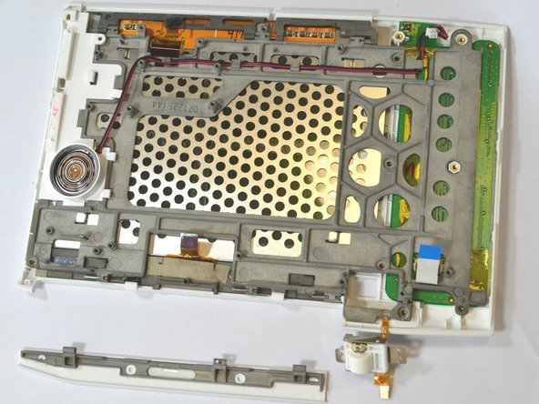

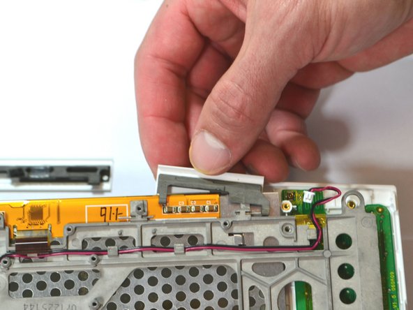

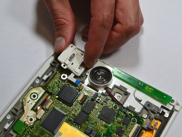

  17. Kindle 1st Generation Screen Replacement: crwdns2935265:017crwdnd2935265:01crwdnd2935265:02crwdne2935265:0 Kindle 1st Generation Screen Replacement: crwdns2935265:017crwdnd2935265:02crwdnd2935265:02crwdne2935265:0
    • Slightly lift the top corner of the panel.
    • Slide the 'PREV PAGE' button out laterally towards the top corner.
  18. Kindle 1st Generation Screen Replacement: crwdns2935265:018crwdnd2935265:01crwdnd2935265:02crwdne2935265:0 Kindle 1st Generation Screen Replacement: crwdns2935265:018crwdnd2935265:02crwdnd2935265:02crwdne2935265:0
    • Slide out the small 'NEXT PAGE' button laterally towards the keyboard.
  19. Kindle 1st Generation Screen Replacement: crwdns2935265:019crwdnd2935265:01crwdnd2935265:02crwdne2935265:0 Kindle 1st Generation Screen Replacement: crwdns2935265:019crwdnd2935265:02crwdnd2935265:02crwdne2935265:0
    • Slide out the small 'BACK' button laterally towards the keyboard.

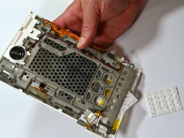

  20. Kindle 1st Generation Screen Replacement, Keyboard/Buttons: crwdns2935265:020crwdnd2935265:01crwdnd2935265:02crwdne2935265:0 Kindle 1st Generation Screen Replacement, Keyboard/Buttons: crwdns2935265:020crwdnd2935265:02crwdnd2935265:02crwdne2935265:0
    • The keyboard and the blue and white ribbon cable will slide out horizontally from behind the frame.
    • The rubber key pads will slide out from behind the frame.

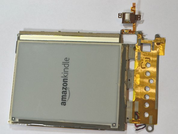

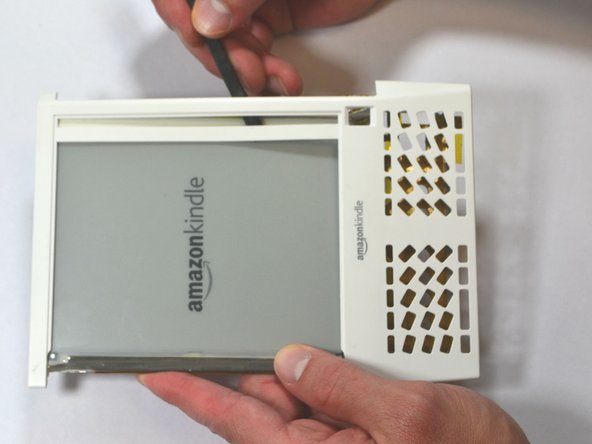

  21. Kindle 1st Generation Screen Replacement, Screen: crwdns2935265:021crwdnd2935265:01crwdnd2935265:03crwdne2935265:0 Kindle 1st Generation Screen Replacement, Screen: crwdns2935265:021crwdnd2935265:02crwdnd2935265:03crwdne2935265:0 Kindle 1st Generation Screen Replacement, Screen: crwdns2935265:021crwdnd2935265:03crwdnd2935265:03crwdne2935265:0
    • Use a spudger to pry the two white tabs off the edge of the metal frame. This will separate the front cover from the metal frame.
    • Use a spudger to break the adhesive holding the front cover onto the screen by sliding it slowly around the edges just underneath the front cover.
    • Do not attempt to remove the metal frame of the screen from the front cover until all adhesive as been separated between the front cover and the screen.
