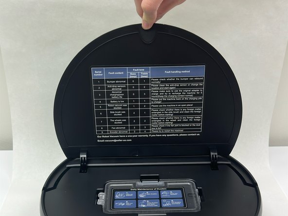

    • Make sure the G20 is right-side-up
  2. Kilgone G20 Dust Bin Filter Replacement: crwdns2935265:02crwdnd2935265:01crwdnd2935265:02crwdne2935265:0 Kilgone G20 Dust Bin Filter Replacement: crwdns2935265:02crwdnd2935265:02crwdnd2935265:02crwdne2935265:0
    • At the front of the G20, there should be a “PULL” label; pull it up to open the vacuum lid.
  3. Kilgone G20 Dust Bin Filter Replacement: crwdns2935265:03crwdnd2935265:01crwdnd2935265:01crwdne2935265:0
    • Use your hands to pinch the tab located on the top of the dustbin.
    • Lift up to remove the dustbin from the G20.

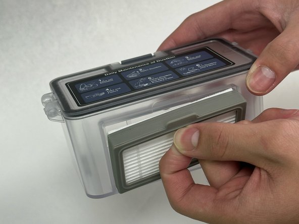

  4. Kilgone G20 Dust Bin Filter Replacement: crwdns2935265:04crwdnd2935265:01crwdnd2935265:02crwdne2935265:0 Kilgone G20 Dust Bin Filter Replacement: crwdns2935265:04crwdnd2935265:02crwdnd2935265:02crwdne2935265:0
    • Remove the dust filter from the dust bin by locating the filter at the side of the bin.
    • Pull it out using the tab.

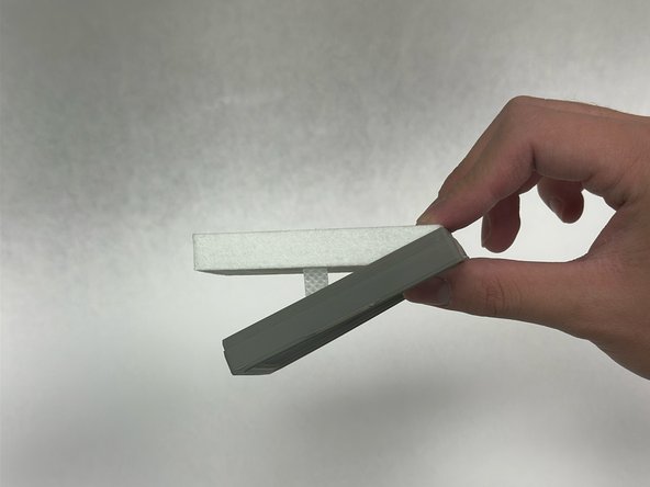

  5. Kilgone G20 Dust Bin Filter Replacement: crwdns2935265:05crwdnd2935265:01crwdnd2935265:02crwdne2935265:0 Kilgone G20 Dust Bin Filter Replacement: crwdns2935265:05crwdnd2935265:02crwdnd2935265:02crwdne2935265:0
    • Carefully remove the dust filter from the silicone casing by popping it out.
