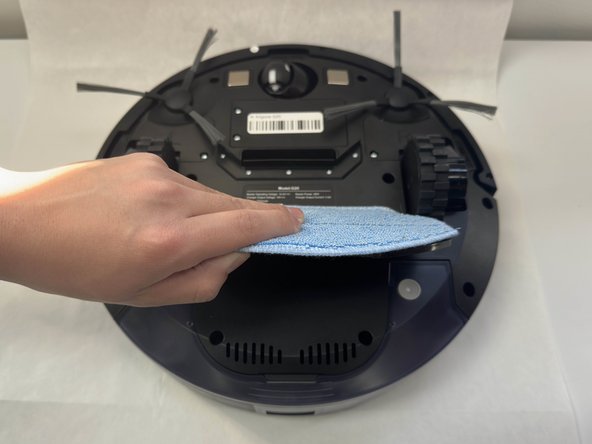

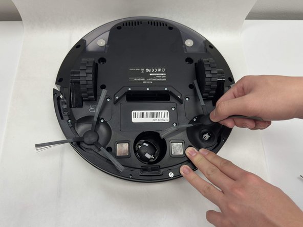

    • Flip the vacuum upside down.
  2. Kilgone G20 Bumper Replacement: crwdns2935265:02crwdnd2935265:01crwdnd2935265:02crwdne2935265:0 Kilgone G20 Bumper Replacement: crwdns2935265:02crwdnd2935265:02crwdnd2935265:02crwdne2935265:0
    • Grip the brush firmly.
    • Pull up on the brush with force, and it will pop out of place.
    • Repeat for the other side.

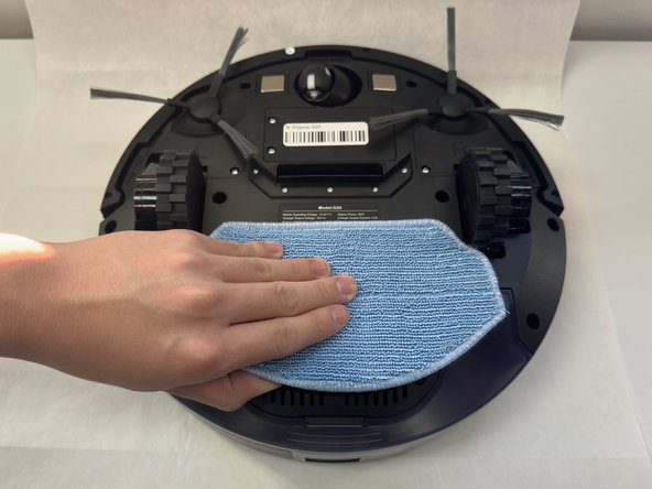

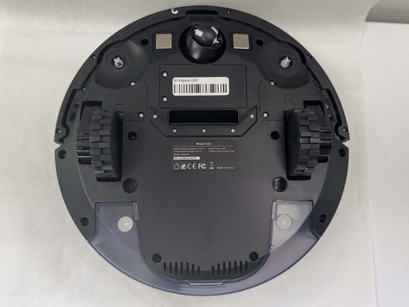

    • Remove the mop pad.

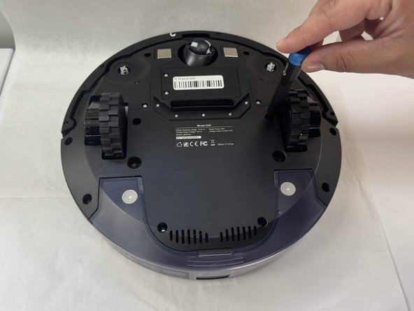

  4. Kilgone G20 Bumper Replacement: crwdns2935265:04crwdnd2935265:01crwdnd2935265:03crwdne2935265:0 Kilgone G20 Bumper Replacement: crwdns2935265:04crwdnd2935265:02crwdnd2935265:03crwdne2935265:0 Kilgone G20 Bumper Replacement: crwdns2935265:04crwdnd2935265:03crwdnd2935265:03crwdne2935265:0
    • Remove all ten of the 3.8 x 12.2 mm screws using a Phillips #1 screwdriver.

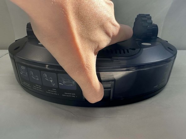

  5. Kilgone G20 Bumper Replacement: crwdns2935265:05crwdnd2935265:01crwdnd2935265:03crwdne2935265:0 Kilgone G20 Bumper Replacement: crwdns2935265:05crwdnd2935265:02crwdnd2935265:03crwdne2935265:0 Kilgone G20 Bumper Replacement: crwdns2935265:05crwdnd2935265:03crwdnd2935265:03crwdne2935265:0

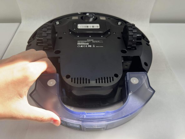

    • Pull up on the tab that's on the mop solution container. Lift and pull up simultaneously in order to remove the bin.
    • Set aside the bin.

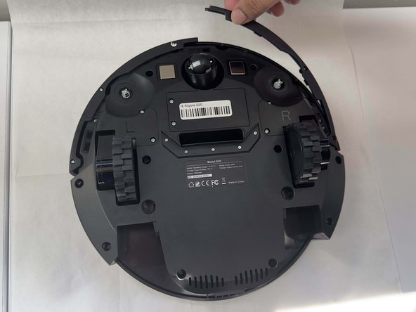

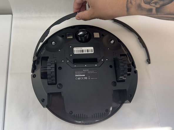

    • Remove the six 2.3 x 7.3 mm screws that secure the bottom of the bumper with a Phillips #1 screwdriver.
    • Pull up on both sides of the bumper, and set them aside somewhere along with the screws.

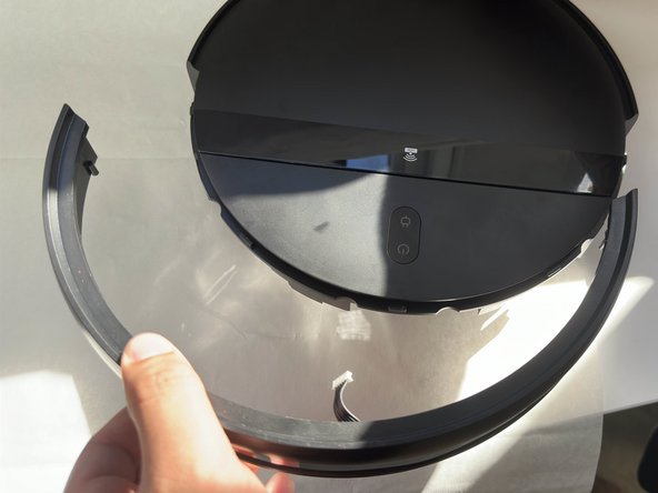

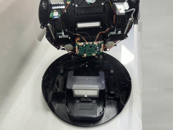

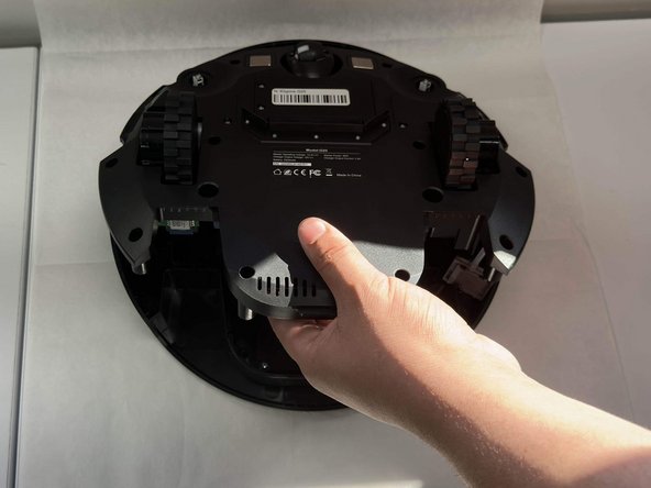

    • Gently lift up in order to seperate the bottom of the vacuum from the top.
    • Take care not to strain the cables, as the bumper is attached to the motherboard/main circuit via wire.

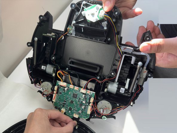

  8. Kilgone G20 Bumper Replacement: crwdns2935265:08crwdnd2935265:01crwdnd2935265:03crwdne2935265:0 Kilgone G20 Bumper Replacement: crwdns2935265:08crwdnd2935265:02crwdnd2935265:03crwdne2935265:0 Kilgone G20 Bumper Replacement: crwdns2935265:08crwdnd2935265:03crwdnd2935265:03crwdne2935265:0
    • Find the cable that connects from the bumper to the motherboard.
    • Cautiously wiggle out and remove the cable from port that the cable is connected to, as seen in the second image.
  9. Kilgone G20 Bumper Replacement: crwdns2935265:09crwdnd2935265:01crwdnd2935265:02crwdne2935265:0 Kilgone G20 Bumper Replacement: crwdns2935265:09crwdnd2935265:02crwdnd2935265:02crwdne2935265:0
    • Using both hands, pick up the G20.
    • Now gently wiggle the bumper out from its place, and it should pop out. Use one hand to hold the G20 steadily, and one to take the bumper out of place.
