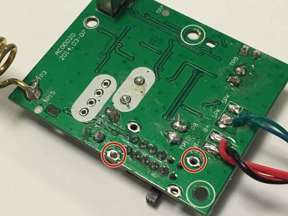

    • Use the soldering iron to remove the broken switch.
    • Push down on the metal locks to separate the switch from the motherboard.
