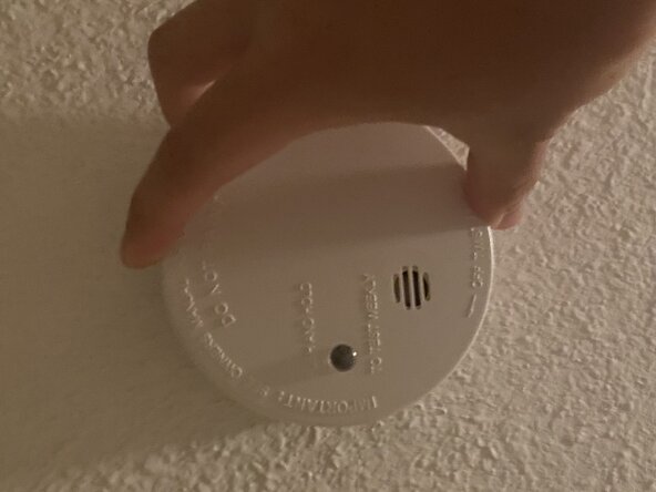

    • Place a ladder securely underneath the smoke detector.
  2. Kidde Fire Sentry Smoke Detector Battery Replacement: crwdns2935265:02crwdnd2935265:01crwdnd2935265:01crwdne2935265:0
    • Twist the smoke detector clockwise to remove it from the ceiling.
  3. Kidde Fire Sentry Smoke Detector Battery Replacement: crwdns2935265:03crwdnd2935265:01crwdnd2935265:03crwdne2935265:0 Kidde Fire Sentry Smoke Detector Battery Replacement: crwdns2935265:03crwdnd2935265:02crwdnd2935265:03crwdne2935265:0 Kidde Fire Sentry Smoke Detector Battery Replacement: crwdns2935265:03crwdnd2935265:03crwdnd2935265:03crwdne2935265:0
    • This device was missing the battery cover, but if your smoke detector has one, remove it from the bottom of the device.
    • Pull the black strap upwards to remove the old battery.
    • Dispose of the old battery properly.
  4. Kidde Fire Sentry Smoke Detector Battery Replacement: crwdns2935265:04crwdnd2935265:01crwdnd2935265:02crwdne2935265:0 Kidde Fire Sentry Smoke Detector Battery Replacement: crwdns2935265:04crwdnd2935265:02crwdnd2935265:02crwdne2935265:0
    • Push the red switch down with your finger.
  5. Kidde Fire Sentry Smoke Detector Battery Replacement: crwdns2935265:05crwdnd2935265:01crwdnd2935265:01crwdne2935265:0
    • Place the new battery on top of the red switch and black strap.
    • Place the new battery in the battery compartment ensuring the red switch stays down.
    • Make sure the positive and negative sides of battery are oriented correctly.
  6. Kidde Fire Sentry Smoke Detector Battery Replacement: crwdns2935265:06crwdnd2935265:01crwdnd2935265:02crwdne2935265:0 Kidde Fire Sentry Smoke Detector Battery Replacement: crwdns2935265:06crwdnd2935265:02crwdnd2935265:02crwdne2935265:0
    • Press and hold button on the front for three seconds and wait for a beep.
    • After hearing a beep, stop pressing button.
  7. Kidde Fire Sentry Smoke Detector Battery Replacement: crwdns2935265:07crwdnd2935265:01crwdnd2935265:03crwdne2935265:0 Kidde Fire Sentry Smoke Detector Battery Replacement: crwdns2935265:07crwdnd2935265:02crwdnd2935265:03crwdne2935265:0 Kidde Fire Sentry Smoke Detector Battery Replacement: crwdns2935265:07crwdnd2935265:03crwdnd2935265:03crwdne2935265:0
    • Find the grooves located on the back of the smoke detector.
    • Match them with the tabs hanging from the ceiling piece.
    • Twist the smoke detector counter-clockwise to secure it to the ceiling.
