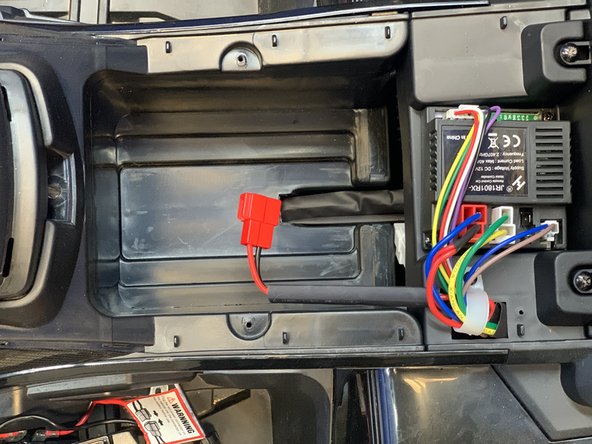

  3. Kid Motorz Xtreme Quad 12V Vehicle Battery Repair: crwdns2935265:03crwdnd2935265:01crwdnd2935265:01crwdne2935265:0
    • Disconnect battery by gently pushing the tabs inwards and carefully unplugging it.
  4. Kid Motorz Xtreme Quad 12V Vehicle Battery Repair: crwdns2935265:04crwdnd2935265:01crwdnd2935265:02crwdne2935265:0 Kid Motorz Xtreme Quad 12V Vehicle Battery Repair: crwdns2935265:04crwdnd2935265:02crwdnd2935265:02crwdne2935265:0
    • Remove the battery terminals and the battery.

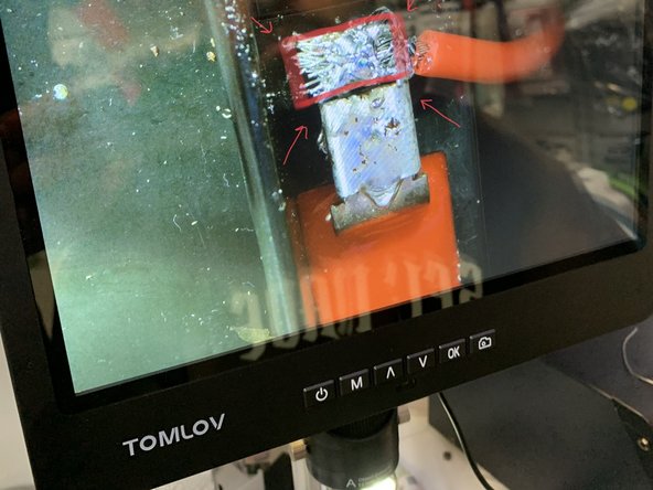

  5. Kid Motorz Xtreme Quad 12V Vehicle Battery Repair: crwdns2935265:05crwdnd2935265:01crwdnd2935265:01crwdne2935265:0
    • Put safety gloves on before beginning to solder.
    • Take your solder and place it carefully on the terminal points of the battery (negative and positive).
  6. Kid Motorz Xtreme Quad 12V Vehicle Battery Repair: crwdns2935265:06crwdnd2935265:01crwdnd2935265:01crwdne2935265:0
    • Apply heat to the solder.
  7. Kid Motorz Xtreme Quad 12V Vehicle Battery Repair: crwdns2935265:07crwdnd2935265:01crwdnd2935265:02crwdne2935265:0 Kid Motorz Xtreme Quad 12V Vehicle Battery Repair: crwdns2935265:07crwdnd2935265:02crwdnd2935265:02crwdne2935265:0
    • Position the wire onto the end piece and apply heat to the solder.
  8. Kid Motorz Xtreme Quad 12V Vehicle Battery Repair: crwdns2935265:08crwdnd2935265:01crwdnd2935265:02crwdne2935265:0 Kid Motorz Xtreme Quad 12V Vehicle Battery Repair: crwdns2935265:08crwdnd2935265:02crwdnd2935265:02crwdne2935265:0
