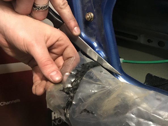

    • Use a sharp knife to cut the strip calk connecting the top half of the moisture shield.
    • Pull the moisture shield half way down.
    • Don't tear the moisture shield cover.
    • The strip calk will still work as an adhesive once taken off so you can stick the moisture shield back onto the door frame.
