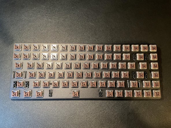

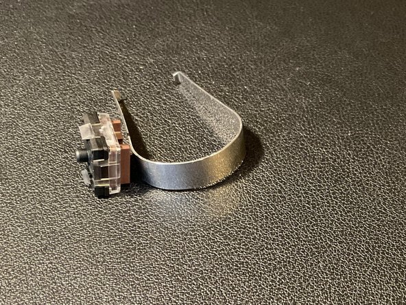

  4. Keychron K3 Ultra-slim Wireless Mechanical Keyboard Disassembly, Removal of Switches: crwdns2935265:04crwdnd2935265:01crwdnd2935265:03crwdne2935265:0 Keychron K3 Ultra-slim Wireless Mechanical Keyboard Disassembly, Removal of Switches: crwdns2935265:04crwdnd2935265:02crwdnd2935265:03crwdne2935265:0 Keychron K3 Ultra-slim Wireless Mechanical Keyboard Disassembly, Removal of Switches: crwdns2935265:04crwdnd2935265:03crwdnd2935265:03crwdne2935265:0
    • Use a switch puller to remove the switches.
    • If you have the included switch puller from Keychrone, it may be tough removing said switches.
    • Each switch has small tabs on the corners to grab and remove them. (The Included switch puller might require extra strength to remove)

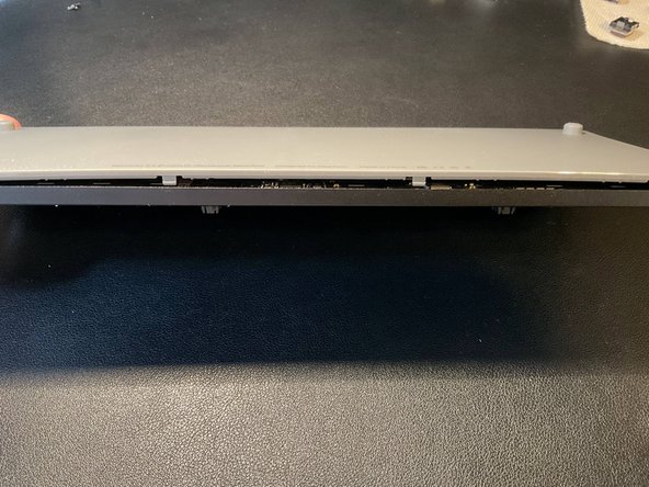

  6. Keychron K3 Ultra-slim Wireless Mechanical Keyboard Disassembly, Separate the Base and Top: crwdns2935265:06crwdnd2935265:01crwdnd2935265:03crwdne2935265:0 Keychron K3 Ultra-slim Wireless Mechanical Keyboard Disassembly, Separate the Base and Top: crwdns2935265:06crwdnd2935265:02crwdnd2935265:03crwdne2935265:0 Keychron K3 Ultra-slim Wireless Mechanical Keyboard Disassembly, Separate the Base and Top: crwdns2935265:06crwdnd2935265:03crwdnd2935265:03crwdne2935265:0
    • Use a spudger or another wedge tool to pry open the plastic base from the aluminum chassis.
    • Use caution when removing the base from the chassis as there are tabs that hold them together!
    • CAUTION: The battery is located on the plastic bottom. The battery is connected to the PCB located near the orange switches and USB

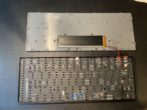

  7. Keychron K3 Ultra-slim Wireless Mechanical Keyboard Disassembly, Disconnect the Battery: crwdns2935265:07crwdnd2935265:01crwdnd2935265:02crwdne2935265:0 Keychron K3 Ultra-slim Wireless Mechanical Keyboard Disassembly, Disconnect the Battery: crwdns2935265:07crwdnd2935265:02crwdnd2935265:02crwdne2935265:0
    • Use tweezers to disconnect the battery from the PCB.
    • Use caution when removing the PCB! Pull away from the connector. Do not attempt to jiggle the cable as this may loosen/damage the connector

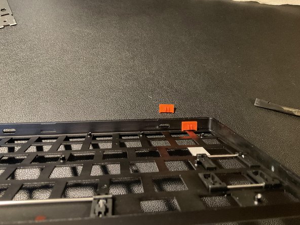

  9. Keychron K3 Ultra-slim Wireless Mechanical Keyboard Disassembly, Disassembly complete: crwdns2935265:09crwdnd2935265:01crwdnd2935265:02crwdne2935265:0 Keychron K3 Ultra-slim Wireless Mechanical Keyboard Disassembly, Disassembly complete: crwdns2935265:09crwdnd2935265:02crwdnd2935265:02crwdne2935265:0
    • The PCB is now removed and able to work on.
    • When you reassemble the keyboard, make sure to put the orange toggles with the two nubs pointing towards the switch side of the aluminum frame.
