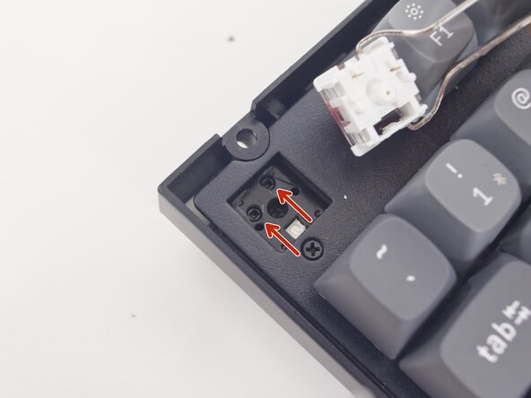

  4. Keychron K10 Max Wireless Mechanical Key Switch Replacement: crwdns2935265:04crwdnd2935265:01crwdnd2935265:03crwdne2935265:0 Keychron K10 Max Wireless Mechanical Key Switch Replacement: crwdns2935265:04crwdnd2935265:02crwdnd2935265:03crwdne2935265:0 Keychron K10 Max Wireless Mechanical Key Switch Replacement: crwdns2935265:04crwdnd2935265:03crwdnd2935265:03crwdne2935265:0
    • The replacement switch is oriented to fit only one way.
    • Align the copper pins on the bottom of the switch with the socket.
    • Make sure the copper pins are aligned before pressing the switch into place. Installing the switch in the wrong orientation can bend or break the pins.
    • Press the switch straight down until it clicks into place.
    • The switch should sit flush with the surrounding switches and the keyboard frame.
Once the switch is installed, you can reassemble your device back to normal. To reassemble your device, follow these instructions in reverse order.
