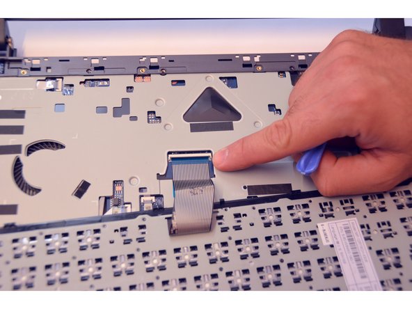

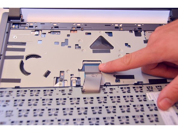

  4. Keyboard replacement: crwdns2935265:04crwdnd2935265:01crwdnd2935265:03crwdne2935265:0 Keyboard replacement: crwdns2935265:04crwdnd2935265:02crwdnd2935265:03crwdne2935265:0 Keyboard replacement: crwdns2935265:04crwdnd2935265:03crwdnd2935265:03crwdne2935265:0
    • Now gently release the keyboard.
    • Then reverse it.
    • Release now by helping you with a screwdriver the keyboard cable.
  5. Keyboard replacement: crwdns2935265:05crwdnd2935265:01crwdnd2935265:01crwdne2935265:0
    • Once the cable is released, lift the keyboard out of its slot.
To reassemble your device follow the following instructions in reverse order
