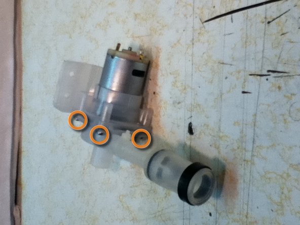

  4. Keurig K75 Water Pump Replacement: crwdns2935265:04crwdnd2935265:01crwdnd2935265:02crwdne2935265:0 Keurig K75 Water Pump Replacement: crwdns2935265:04crwdnd2935265:02crwdnd2935265:02crwdne2935265:0
    • And there you have it. If you have a new one you can now install it.
    • Don't forget to replace those zip ties that you cut off.
    • If you don't have a new one you can try to fix this one by removing these four screws and removing any blockage.
    • Now Keurig doesn't stock spare parts, so unless you can get your hands on another broken machine you will need to fix the existing motor or source a new one. Radio Shack stocks small motors like this, they won't be exact but with a little modification you should be able to get it working.
