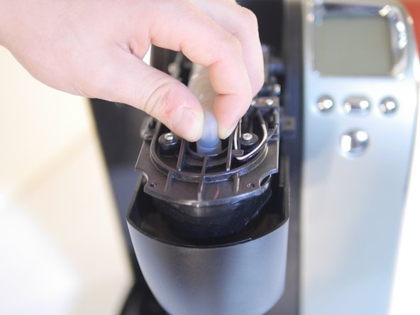

  5. Keurig K70 Top  Needle Replacement: crwdns2935265:05crwdnd2935265:01crwdnd2935265:01crwdne2935265:0
    • Remove the two 8mm screws with a PH #2 screwdriver.
  6. Keurig K70 Top  Needle Replacement: crwdns2935265:06crwdnd2935265:01crwdnd2935265:01crwdne2935265:0
    • Pull out on the top component perpendicular to the top face as shown. It will pop out without too much effort.
    • The needle is now exposed on the bottom of the part being handled in this photo. Be careful where you grab this component, we recommend doing as we have done here. Grab the front "lip" of the component (see photo).

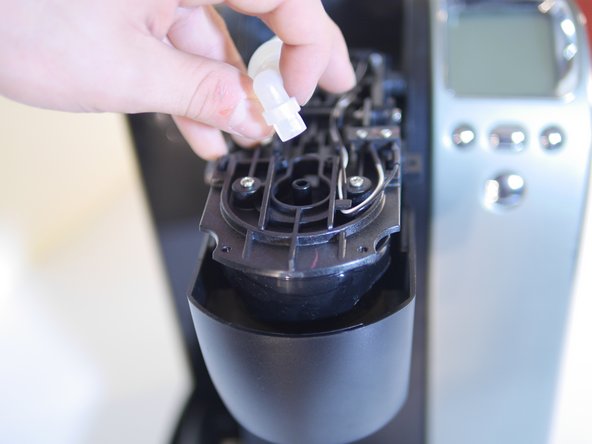

  7. Keurig K70 Top  Needle Replacement: crwdns2935265:07crwdnd2935265:01crwdnd2935265:01crwdne2935265:0
    • This is the component that should detach after pulling down.
    • Be careful of the needle!
  8. Keurig K70 Top  Needle Replacement: crwdns2935265:08crwdnd2935265:01crwdnd2935265:01crwdne2935265:0
    • On the bottom of the component is the exposed needle, which is now accessible.
    • If you remove the needle be careful as it may be sharp.
