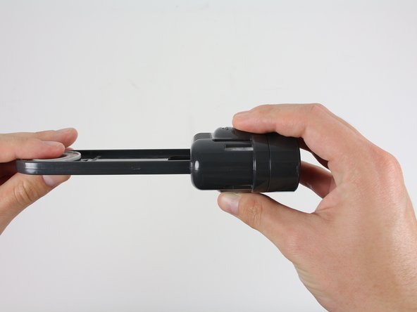

    • Grab the lid of the water reservoir on the left side of the Keurig.
    • Lift up to remove the water reservoir lid.
  2. Keurig K55 Water Filter Replacement: crwdns2935265:02crwdnd2935265:01crwdnd2935265:02crwdne2935265:0 Keurig K55 Water Filter Replacement: crwdns2935265:02crwdnd2935265:02crwdnd2935265:02crwdne2935265:0
    • Grab the water filter on the inside of the reservoir.
    • Remove filter by pulling straight up.
    • Pulling the filter out may require a bit of effort.

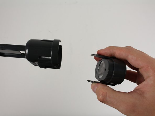

  3. Keurig K55 Water Filter Replacement: crwdns2935265:03crwdnd2935265:01crwdnd2935265:03crwdne2935265:0 Keurig K55 Water Filter Replacement: crwdns2935265:03crwdnd2935265:02crwdnd2935265:03crwdne2935265:0 Keurig K55 Water Filter Replacement: crwdns2935265:03crwdnd2935265:03crwdnd2935265:03crwdne2935265:0
    • Pinch both sides of end cap on the large end of the filter.
    • With both tabs compressed, pull the cap off of the housing.

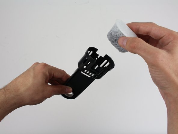

  4. Keurig K55 Water Filter Replacement: crwdns2935265:04crwdnd2935265:01crwdnd2935265:02crwdne2935265:0 Keurig K55 Water Filter Replacement: crwdns2935265:04crwdnd2935265:02crwdnd2935265:02crwdne2935265:0
    • Remove exposed filter.
