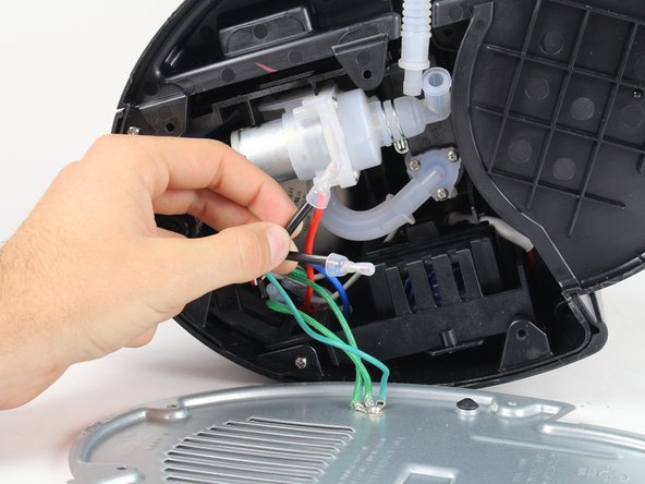

    • Access the bottom of the Keurig by flipping it on its side.
  2. Keurig K55 Power Cable Replacement: crwdns2935265:02crwdnd2935265:01crwdnd2935265:03crwdne2935265:0 Keurig K55 Power Cable Replacement: crwdns2935265:02crwdnd2935265:02crwdnd2935265:03crwdne2935265:0 Keurig K55 Power Cable Replacement: crwdns2935265:02crwdnd2935265:03crwdnd2935265:03crwdne2935265:0
    • Remove the five 13mm Phillips #0 screws securing the bottom case.
    • Pull the silver cover off of the device.

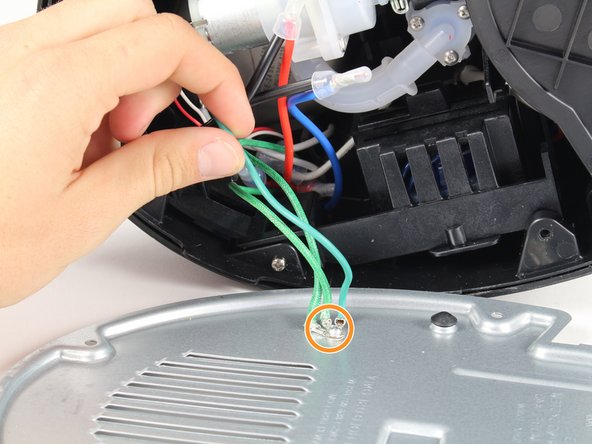

  3. Keurig K55 Power Cable Replacement: crwdns2935265:03crwdnd2935265:01crwdnd2935265:03crwdne2935265:0 Keurig K55 Power Cable Replacement: crwdns2935265:03crwdnd2935265:02crwdnd2935265:03crwdne2935265:0 Keurig K55 Power Cable Replacement: crwdns2935265:03crwdnd2935265:03crwdnd2935265:03crwdne2935265:0
    • To remove the power cable, highlighted in red, follow iFixit's guide on soldering.
    • The ground cable, highlighted in orange, needs to be re-soldered to your new power cable.
