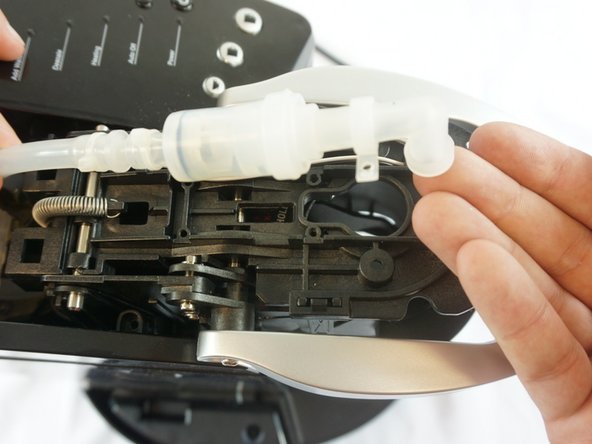

  3. Keurig K40 Spring  Replacement: crwdns2935265:03crwdnd2935265:01crwdnd2935265:03crwdne2935265:0 Keurig K40 Spring  Replacement: crwdns2935265:03crwdnd2935265:02crwdnd2935265:03crwdne2935265:0 Keurig K40 Spring  Replacement: crwdns2935265:03crwdnd2935265:03crwdnd2935265:03crwdne2935265:0
    • Using the Phillips #0 screwdriver unscrew two 2mm screws on the water pump.
    • Once unscrewed lift the water pump up and pull and twist it off.

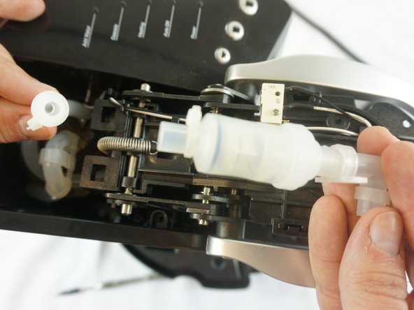

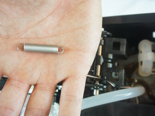

  4. Keurig K40 Spring  Replacement: crwdns2935265:04crwdnd2935265:01crwdnd2935265:02crwdne2935265:0 Keurig K40 Spring  Replacement: crwdns2935265:04crwdnd2935265:02crwdnd2935265:02crwdne2935265:0
    • Using the tweezer and the plastic opening tool grab the front of the spring to take it off.
