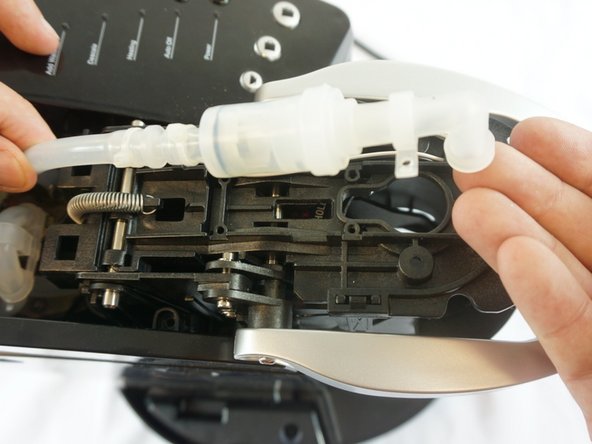

  3. Keurig K40 Open/Close Sensor Replacement: crwdns2935265:03crwdnd2935265:01crwdnd2935265:02crwdne2935265:0 Keurig K40 Open/Close Sensor Replacement: crwdns2935265:03crwdnd2935265:02crwdnd2935265:02crwdne2935265:0
    • Keeping one hand firmly placed on the device, tug upwards on the water pump until it is separated from the device.
    • The water pump and pipe should now be loose and easy to move as shown.

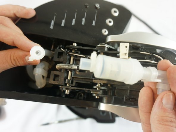

  4. Keurig K40 Open/Close Sensor Replacement: crwdns2935265:04crwdnd2935265:01crwdnd2935265:02crwdne2935265:0 Keurig K40 Open/Close Sensor Replacement: crwdns2935265:04crwdnd2935265:02crwdnd2935265:02crwdne2935265:0
    • Pull on the point where the pipe meets the water pump.
    • The pipe will come loose and the water filter will be free and ready to be replaced.

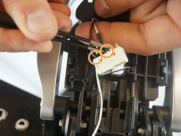

  5. Keurig K40 Open/Close Sensor Replacement, Open/Closed Sensor: crwdns2935265:05crwdnd2935265:01crwdnd2935265:02crwdne2935265:0 Keurig K40 Open/Close Sensor Replacement, Open/Closed Sensor: crwdns2935265:05crwdnd2935265:02crwdnd2935265:02crwdne2935265:0
    • Using a #2 Philips head screwdriver remove the 1.2mm screw holding the sensor in place.
    • Locate where the connections are soldered to the sensor
  6. Keurig K40 Open/Close Sensor Replacement: crwdns2935265:06crwdnd2935265:01crwdnd2935265:01crwdne2935265:0
    • Melt the solder that is connected to the sensor.
    • Be careful to avoid any rubber and try to only contact the metal making the connection.
  7. Keurig K40 Open/Close Sensor Replacement: crwdns2935265:07crwdnd2935265:01crwdnd2935265:01crwdne2935265:0
    • Put the replacement sensor back on the post that holds it and begin to solder the two metal connections back to the sensor.
    • Be careful not to touch the end of the soldering iron.
